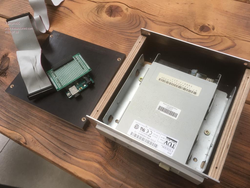

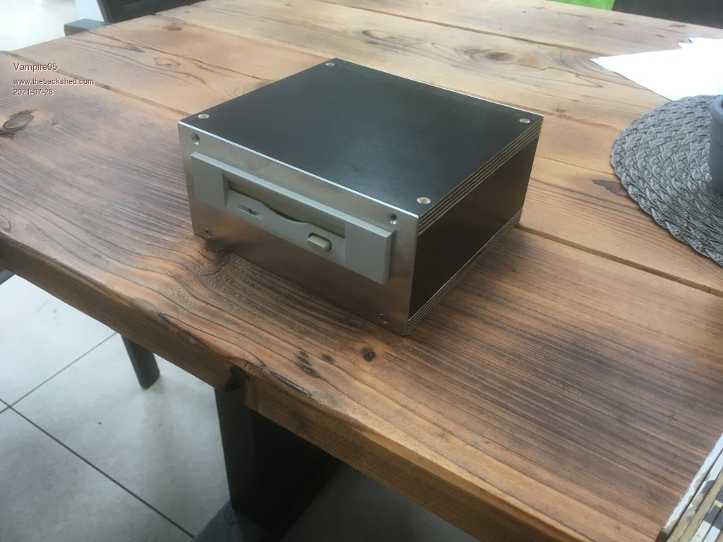

Today i finished the case for my external CMM2 Floppy Drive: Here some Pics:
The next Step is to mount an IDE (40 Pin) Connector on the backside for the CMM2 Connection.
Edited 2021-07-28 02:21 by Vampire05

Posted: 05:13pm 27 Jul 2021
Wow. That looks ROBUST!

Posted: 05:18pm 27 Jul 2021
these wooden panels and aluminuim sheets are the only material i have lying around here.
Posts: 9027
Posted: 06:23pm 27 Jul 2021
It won't blow off the table anyway. :)
Actually, I think it looks really neat. Your cutting and assembly look very precise.

Good work Vampire05,
It won't be long before we hear the buzzing and sizzling of the floppy....
I remember the excitement when my old Acorn Atom was reading disks with a home-brew disk interface (5 1/4 back then). The 160k back ten was sufficient for 20-50 programs. Good that we have 1.44Mb now with the CMM2.
