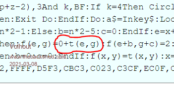

Posts: 6620
Posted: 09:32pm 07 Mar 2021
  Volhout said  OK here is my entry for the BASIC 10 liners.
I simply loved this challenge. And since I use a CMM1 I cannot really compete with the  100x48 challenge on CMM2. A CMM1 basic is simply cannot match up to CMM2 basic.
My entry:             TLS = Ten Line Sokoban
The only change I had to make to the program to run it on a CMM2 was add
OPTION LEGACY ON
to the beginning and change variable f to g
You can not have a simple variable with the same name as an array.
I think you should be allowed the extra line for OPTION LEGACY ON

s=13:Dim f(s,s),t(s,s):Do:Mode 4:z=9:Read x,y:For i=1To s:Read a$:l=Val("&h"+a$)
For j=1To s:w=2^((j-1)*2):m=3*w:f(i,j)=(l And m)/w:If f(i,j)<2Then t(i,j)=f(i,j)
Next j,i:Print @(99,10)"TLS":f(x,y)=4:Do:If a$="r"Then:Restore:Exit Do:EndIf:d=1
For i=1To s:For j=1To s:k=f(i,j):If k=1Then:d=0:EndIf:o=120+z*(i-6):p=100+z*(j-6)
Line(o,p)-(o+z-2,p+z-2),3And k,BF:If k=4Then Circle(o+z/2-1,p+z/2-1),3,6,,F:EndIf
Next j,i:If d=1Then:Exit Do:EndIf:Do:a$=Inkey$:Loop While a$="":n=3And Asc(a$)
If n<2Then:b=0:c=n*2-1:Else:b=n*2-5:c=0:EndIf:e=x+b:g=y+c:If f(e,g)=2Then
If f(e+b,g+c)=<1Then:f(e,g)=0+t(e,g):f(e+b,g+c)=2:Else:b=0:c=0:EndIf
ElseIf f(e,g)=3Then:b=0:c=0:EndIf:f(x,y)=t(x,y):x=x+b:y=y+c:f(x,y)=4
Loop:Loop:Data 2,2,FFFF,D5F3,CBC3,C023,C3CF,EC0F,C0FF,FFFF,0,0,0,0,0
