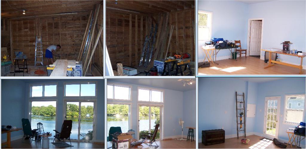

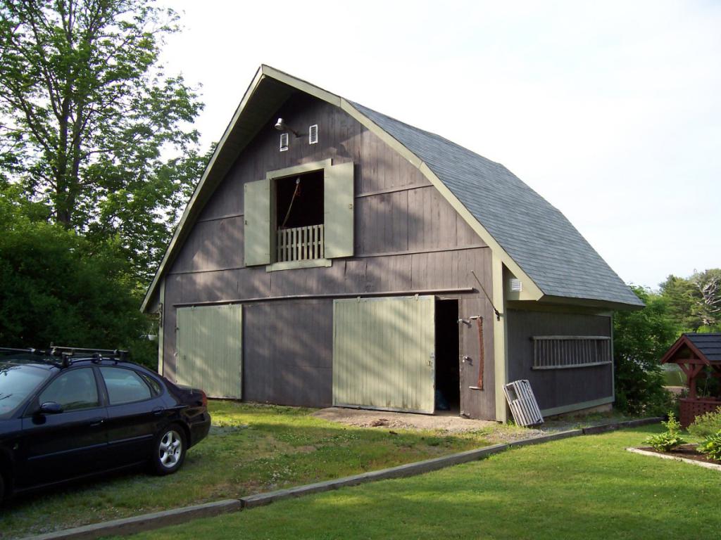

  thwill said  ... in a "barn"
Barn enough for you?
Right-side interior changed a bit in 2004:
Shots below construction views are "after" views. Wooden table in upper right now turned to come out from the wall and completely covered with electronics stuff, including VGA monitor.
My view: live webcam
Eagles regularly come to that big snag on the right.
And the whole thing is just a tad more crowded than those shots show.

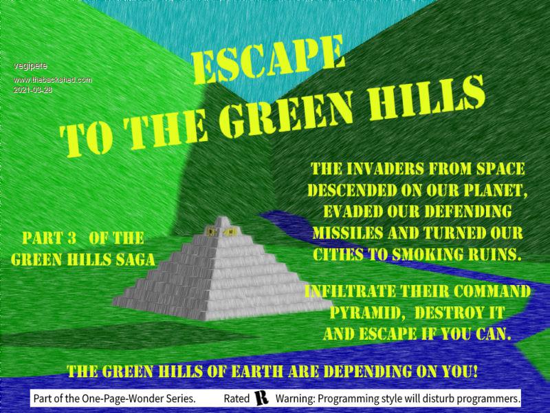

Here is another One Page Wonder.
Once again, the Green Hills are under attack! Do you have what it takes to take command?
This requires a mouse and uses all three buttons - left, right and wheel. Move the mouse for targeting, of course.
If your mouse is connected directly to the CMM2, you will need (and will probably already be using) beta firmware 5.07.00bX.
If your mouse is connected through a Hobbytronics or equivalent, firmware release 5.06.00 should work fine.
The very first statement of the first line sets the mouse port. Adjust this to match your system. "mp=0" means use the built-in port available with 5.07.00bX
If you don't have a mouse? Well, I guess the green hills are doomed.

Part Three of the Green Hills Saga!
To round things off as the contest comes to a close, I have created a
third episode, "Escape to the Green Hills" in which the player must
navigate a maze. The alien command pyramid is hovering just above the
ground. Your job is to find and activate the self-destruct device. Others
have tried before you but apparently without success. We hope someone has
left a message for you. As far as we know, all levels except the smallest
one near the top, where we can infiltrate you, have an item of interest.
But beware! Some of those items are likely to be aliens, greenish blobs
according to reports. Destroy the pyramid to save the green hills, and
hopefully escape out the bottom to tell the tale.
Here is a zip
with all 3 episodes, plus expanded copies, more info and a maze utility.
It took some squashing to get this one in ... plus a fight with a DATA bug.
The largest maze is 19x19!
