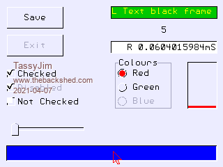

  CaptainBoing said  Thanks Steve.
I have updated the code to provide your cursor controls inside the slider touch processor.

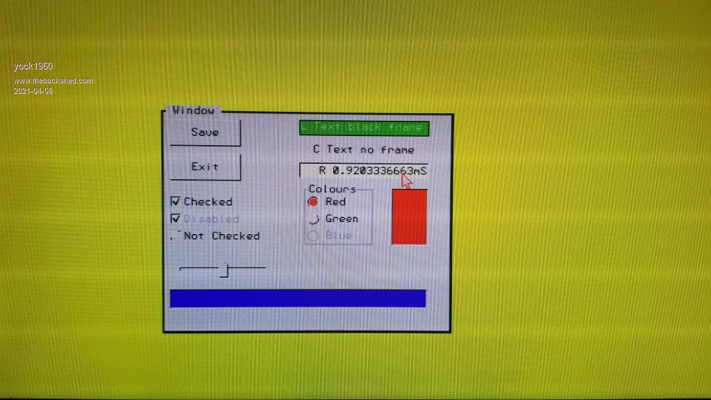

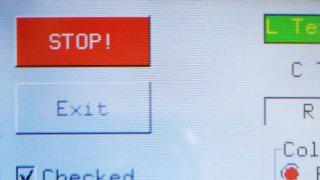

Can't see that the checkbox needs any tweaking? Could you grab a closeup on the CMM2?
F4 LCD Panel:
Sure thing Captain. Here is a screen grab showing the correct checked boxes and incorrect unchecked state, where you can see the small white square is not centered in the frame. Adding +2 to the x,y values inside Case 3 of GuiObjDraw fixes this on my CMM2. Maybe I futzed around and broke this at some point. I no longer have a 'virgin' copy of the code I originally downloaded and with the updates on the Wiki page changing between some lines combined by using colons and then not...it's more difficult to compare from one version to the next to see what's changed....not to mention my own 'CMM2' customizations! I'm pretty sure it was this way when I first got this to run on my machine....but...memory is a funny thing...
Steve

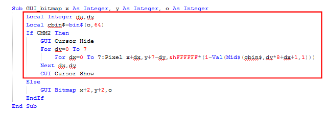

yes the code that was "released" standardized the function names etc and I colon-ised some of the lines with common task i.e. drawing boxes etc. to save a little bit of space - it's not a problem for big boys toys but most of my work is on the minuscule '170 with just 60K of precious program space.

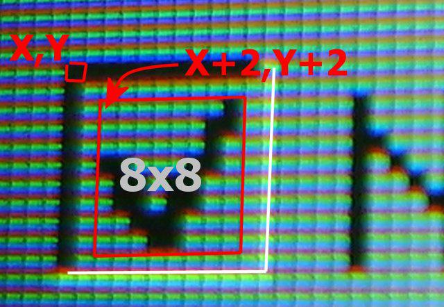

I have just notice something else with the CMM2 GUI Bitmap work-a-like, the tick in the disabled checkbox should be grey (same as the writing). The colour is switched appropriately in GUIObjDraw.
On the subject of the grey box, yes I can see clearly it is shifted up and left. I think the CMM2 switch in GUI bitmap needs investigating - if the bitmap is right for the tick, but wrong for the grey box,  co-ordinates are co-ordinates.
The GUI Bitmap (native to non CMM2 MMBasic) does the positioning correctly:
so the mis-location must be in the emulation but why only for the blanking effect?
the native version (below that) does indeed use the +2 offset as you mentioned and as is shown in the close-up
EDIT: I am going to move the two Local defs inside the IF to streamline and save some RAM - only going to matter of the micromite and functionally the same... so...

yock1960
Joined: 18/08/2020
Posts: 167
Posted: 09:09pm 06 Apr 2021
  CaptainBoing said  yes the code that was "released" standardized the function names etc and I colon-ised some of the lines with common task i.e. drawing boxes etc. to save a little bit of space - it's not a problem for big boys toys but most of my work is on the minuscule '170 with just 60K of precious program space.
If you want what I would call the background of the checkbox to be grey, then change
dc=&hffffff in GUI_bitmap to dc=&hdddddd. That being done, it looks like there is 1 bit/pixel that remains white when checked....only noticeable if you put your nose up to the screen. I have no idea how to figure that one out!

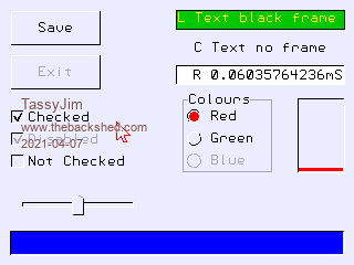

Running the current version V0.64 on a CMM2 I get
CMM2 doesn't have BACKLIGHT so I moved that line into the SELECT CASE block.
Case Else
   Backlight 80' 100 is off
End Select
The checkbox offsets are obvious so I removed the +2 from the GUI BITMAP lines and re-inserted them in the main loop where you call gui_bitmap. That way both methods have the same offset.
Next issue is the not-grey in the disabled tickbox.
This was fixed in the gui_bitmap sub
(if you don't specify a colour, the already set colour is sued, which is what we want)
For dx=0 To 7 : if Val(Mid$(cbin$,dy*8+dx+1,1)) then pixel x+dx,y+7-dy
The full GUI_bitmap sub:
Sub GUI_bitmap x As Integer, y As Integer, o As Integer
If CMM2 Then
Local Integer dx,dy
Local cbin$=bin$(o,64)
GUI Cursor Hide
For dy=0 To 7
Next dx,dy
GUI Cursor Show
Else
GUI Bitmap x,y,o
EndIf
End Sub
Result:
One issue I have. The tickbox can get the tick added with a click but it cannot get removed.

With regards the tick removal, if I understand you right, the tick doesn't get erased(?).
if o=0 you could simply draw a filled box in CGy to erase the tick, so...
If CMM2 Then
If o then
 Local Integer dx,dy
 GUI Cursor Hide
 For dy=0 To 7
 Next dx,dy
 GUI Cursor Show
Else
 Box x+1,y+1,10,10,CGy,CGy
EndIf
Else
Not exactly an emulation of GUI BitMap but should work (and fast too)
... or I could have entirely missed the point
the other way is to plot the pixel no matter what and use CGy for 0 pixels... again not a pure emulation but should erase the tick the sme way as it gets drawn.
All of the above is speculation as i can't test
Edited 2021-04-07 20:17 by CaptainBoing

In addition to TassyJim's mod to GUIbitmap sub, if you add a variable for color in GuiObjDraw and add the bitmap argument for both cases, adding the grey color for the unchecked state, the checkbox case like so:
   Case 3'checkbox
         If o(1,n,2) And 8 Then'visible
           Colour 0
           Line x,y,x,y+11'|
           Line x,y,x+11,y'-
           Colour &hffffff
           Line x+11,y,x+11,y+11'|
           Line x,y+11,x,y+11'_
           If o(1,n,2) And 4 Then'Enabled
             c = 0
           Else'ghosted
             c = &h999999
           EndIf
           If o(1,n,2) And 32 Then'checked
             color c
             GUI_bitmap x+2,y+2,&h18386C6CC6020301
           Else
             COLOR &hdddddd
           EndIf
           Text x+15,y+(h/2)-(FONTHEIGHT()/2),Ot(n),,,,c,cGy
         Else'disappear
           GUIObjCleanup n,1
         EndIf
gives you the desired result I think....for the CMM2 at least!
Steve
Edited 2021-04-07 20:53 by yock1960

I went with:
SUB GUI_bitmap x AS INTEGER, y AS INTEGER, o AS INTEGER
 IF CMM2 THEN
   LOCAL INTEGER dx,dy
   LOCAL cbin$=BIN$(o,64)
   GUI CURSOR HIDE
   FOR dy=0 TO 7
     FOR dx=0 TO 7
       IF VAL(MID$(cbin$,dy*8+dx+1,1)) THEN
         PIXEL x+dx,y+7-dy
       ELSE
         PIXEL x+dx,y+7-dy,CGy
       ENDIF
   NEXT dx,dy
   GUI CURSOR SHOW
 ELSE
   GUI BITMAP x,y,o
 ENDIF
END SUB
Trying to cater for both results in inflated code so there has to be an easy way to remove the CMM2 sections.
While the compatibility functions are minimal and grouped together, that is quick to do.

Works for me! I've incorporated it into my bastard.

small point, it should be GUI BITMAP x+2,y+2,o - see the closeup pic further up this thread

I haven't tried the V0.68 yet but can confirm that GUI BITMAP works on the CMM2
You do need to hide the cursor before placing the bitmap so my sub now looks like this:
 IF CMM2 THEN GUI CURSOR HIDE
   GUI BITMAP x,y,o
 IF CMM2 THEN GUI CURSOR SHOW
END SUB
Not the only way to write it but the one that takes up the minimum lines

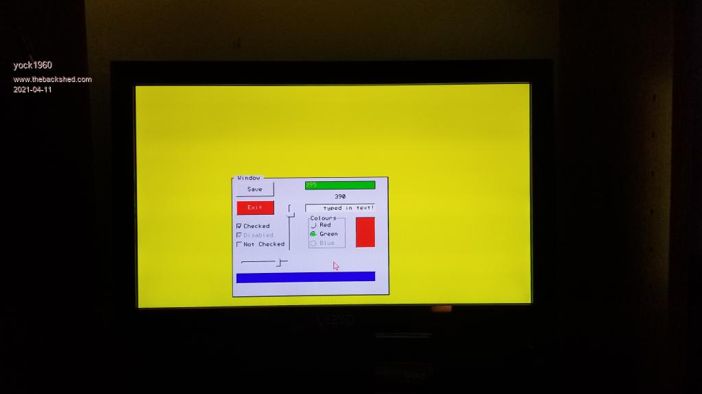

Still futzing around with this. I've added vertical sliders and I suppose I will eventually add the ability to specify which way the pointer points. This is probably too 'expensive' for non CMM2 hardware, but it's nice to have the option and doing this helps to better understand how everything works. And before the question is asked....I'm not planning on 'forking' CaptainBoing's Wiki page for a CMM2 version....more than I want to do!
Steve

see? that's nice - vertical slider - never occurred to me.
one point, I think H & V should really follow the same mechanism as progress bars for alignment otherwise we have inconsistency in specifying orientation, but it is entirely down to how you want to grow your own code. I will lift your vertical slider section of code and tweak it and include it in the next version.
Good work
see the Border type and alignment section
as an aside, I think if you right-click the mouse it will grab the screen for you rather than having to take a photo - jus' sayin'
Edited 2021-04-11 19:15 by CaptainBoing

  CaptainBoing said  see? that's nice - vertical slider - never occurred to me.
Good work
DOH! Yes, much better than a photo! Getting rid of the H/V would be better, but as sliders don't have a border...I didn't have another idea there. It is a bit fiddly getting the desired result into linked objects, as they way the code works in ProcessTouch, up ends up low and vice-versa. There's probably a way around this...but I was unable to figure it out!
I'm currently working on the demo code that allows input into a textbox...trying to develop a general 'method' as it were. Trying to constrain text to the box dimensions is proving to be obstinate...perhaps I was just sleepy...dim witted is more likely!
Steve
