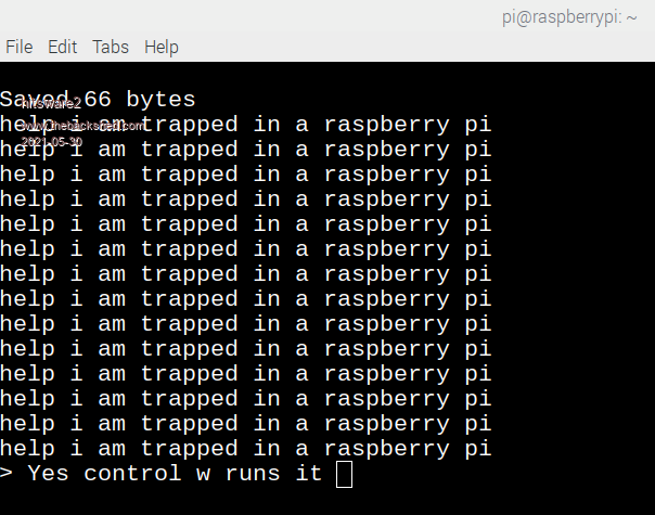

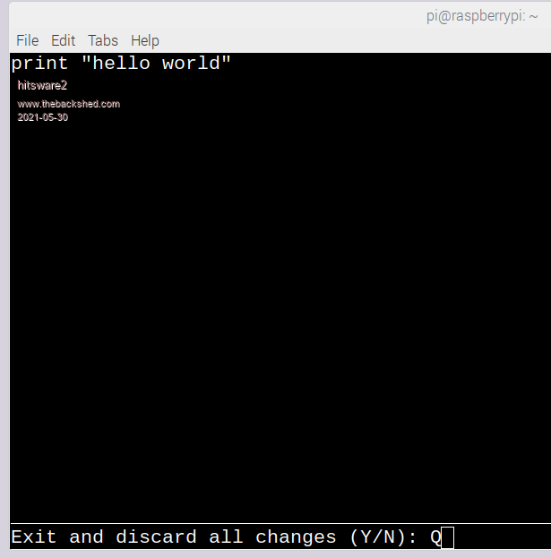

Posted: 06:36pm 29 May 2021
I get the editor screen ,
but when I try to RUN ....
my site

  hitsware2 said  I get the editor screen ,
<IMAGE>
yep, i got that with minicom, but not with GFXterm64. looks like you may need to use the alternative control codes from the micromite manual, pg32:
f1:         ctrl-Q
f2:         ctrl-W
f3:         ctrl-R
f4:         ctrl-T
f5:         ctrl-Y
shift f3:   ctrl-G
it seems to be a shortfalling of minicom, and no doubt some other linux terminals.
rob   :-)

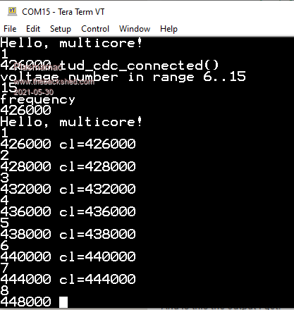

Posts: 2556
Posted: 08:21pm 29 May 2021
  matherp said
  Quote  i shall ask a question on the pico forums and see what people say.
Good luck - I haven't had a useful answer on anything I've asked so far. Flash block size is 4K
replies here:
https://www.raspberrypi.org/forums/viewtopic.php?f=145&t=312883
suggestion seems to be simply do one block (4k) at a time, with each call to erase and write bracketed with interrupt_disable and interrupt_enable, and a few NOPs sprinkled in between to ensure any pending interrupt is handled:
for i=1 to n
  disable_ints
  erase_block
  enable_ints
  nop
  disable_ints
  write_block
  enable_ints
next i
even if it took 2ms to erase or write a 4k block, 100k could be handled in 100ms or so, which seems perfectly acceptable. i did read somewhere that one should avoid writing to the (USB) console while doing this, so make sure the console is flushed before starting.
rob   :-)

multicore_hang.zip
rpi forum
Plasma

hitsware2
Joined: 03/08/2019
Posts: 738
Posted: 11:33pm 29 May 2021
f1:         ctrl-Q
f2:         ctrl-W
f3:         ctrl-R
f4:         ctrl-T
f5:         ctrl-Y
shift f3:   ctrl-G
rob   :-)
Thank You   .... ctrl-W runs it ....
Strange ( to me ) that You would blame Linux terminals , rather than the code ?
Edited 2021-05-30 09:34 by hitsware2
my site

  hitsware2 said
  robert.rozee said  yep, i got that with minicom, but not with GFXterm64. looks like you may need to use the alternative control codes from the micromite manual, pg32:
f1:         ctrl-Q
f2:         ctrl-W
f3:         ctrl-R
f4:         ctrl-T
f5:         ctrl-Y
shift f3:   ctrl-G
rob   :-)
it is just that minicom is strictly emulating a VT102 terminal, and as such does not have function keys that the mmbasic editor fully understands. you'll also find that while <pg up> and <pg down> keys work correctly with the mmbasic editor, <home> and <end> do not.
