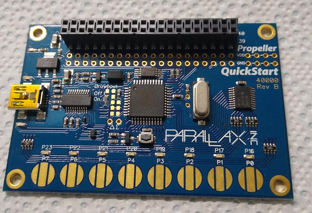

Tinine
Joined: 30/03/2016
Posts: 1646
Posted: 08:12am 27 May 2022
Well Mick,
I have a bundle of stuff here to pass on to you....when we finally meet
Think I might just sneek a Propeller board in there
You will soon be addicted

Posted: 08:25am 27 May 2022
This one. It even has touch pads. There is absolutely no difference when it comes to programming until you decide that something is slowing your main loop. Just launch that particular function in a "Cog" and share variables.
Absolute child's play
Craig
