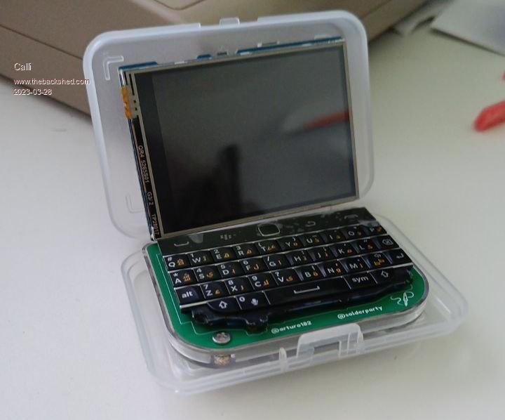

So, some time has passed.
We have now a console on a TFT.
How about a i2c keyboard for editing? Or did I miss that again?
Thats how my dream looks right now
The "case" is just the packaging of the small keyboard :)
Oh yes, it contains a RP2040... It also should (is maybe) be possible to have serial output... I mean...
Best,
Carsten

I suspect that using a i2c keyboard for editing won't be possible. Not without major changes to MMBasic anyway. You really need to convert the i2c to PS2 somehow.
That's a nice looking little keyboard. :)

Calli
Joined: 20/10/2021
Posts: 74
Posted: 12:08pm 28 Mar 2023
The keyboard: https://linktr.ee/bbq20kbd
It is open hardware but the developer also sells it. Check the GitHub etc.
And sure enough it has a rp2040 as CPU. And comes with the source.
There is even a serial port which is used for debug.
While the console way is certainly possible it would mean to do a vt100 emulation to use the internal editor. I am not sure how the VGA/PS2 Version does this.
Cheers,
Carsten

Posts: 9187
Posted: 07:19am 29 Mar 2023
If the keyboard has a RP2040 and comes with the source code then you know the pins used and what for - and how to scan the keys. The I2C output routine needs to be modified to be a PS2 output routine and the scan code lookup table may need to be changed to suit the PA2 standard. I wonder if there's any chance of the designer making a PS2 version? It's lucky that we only want 3V3 PA2 - there's no level shifting.
I wonder if the keyboard could be re-programmed to run MMBasic to make things easier for us to do it? You'd need to check what pins have been used and what for.
I hope the LCD display is one that's compatible with a PicoMite. With the keyboard reprogrammed and connected as PS2 and a non-VGA PicoMite added and linked to the display all is well.

Posts: 11999
Posted: 07:03am 05 Apr 2023
Have you seen that I have included full support for that keyboard in the firmware?
See here
