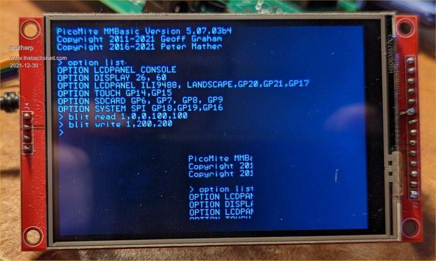

  matherp said  Note: as has been discussed many times, there is a H/W bug in the ILI9488 controller chip which means it doesn't release the MISO pin even when it is not chip selected. This means that the SPI bus can't be shared with the touch controller or an SDDcard.
Some people don't connect the display MISO pin in which case touch and the SDcard will work but then you can't read the display framebuffer so BLIT, transparent text and console mode can't work.

BLIT READ works perfectly on the ILI9488 with the latest firmware IFF MISO is connected

  matherp said  BLIT READ works perfectly on the ILI9488 with the latest firmware IFF MISO is connected
Yes, and thanks, but if I understand correctly, that's because the SD card and any other SPI devices are on different pins.
I think Turbo46 is talking about whether an inline 1K resistor on the ILI9488 MISO pin would allow it to function on the same MISO, MOSI, & CLK pins as the SD card without corruption.
That's what I'm not sure can be fully tested with either the new or the older firmware.

  Quote  That's what I'm not sure can be fully tested with either the new or the older firmware.
Of course it can. Connect it and see it it works with the SDcard on the System SPI
  Quote  It doesn't matter which GP Pins I use I always get Invalid Option.
Have you set up the System SPI? Follow the instructions for the ILI9341 in the manual and just substitute ILI9488
