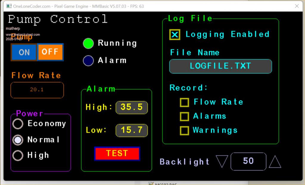

Posted: 07:48pm 26 Jan 2022
NOW with full GUI and Mouse support
MMBasic.zip
Really happy with this
You can interrogate the mouse with the mouse function
MOUSE(X) 'gets the x-coordinate
MOUSE(Y) 'gets the y-coordinate
MOUSE(W [,scale]) get the movement of the wheel since the last call of the function
Use scale to adjust the sensitivity by dividing the internal count by scale (default 1)
MOUSE(L) 'gets the left  mouse button (1 is pressed)
MOUSE(M) 'gets the middle  mouse button (1 is pressed)
MOUSE(R) 'gets the right  mouse button (1 is pressed)
MOUSE(D)
D This allows you to detect a double click of the left mouse button .
The algorithm say the two clicks must occur between 100 and 500
milliseconds apart. The report via MOUSE(D) is then valid for 500mSec
before it times out or until it is read.
NB: MM+ TOUCH() function is automatically translated to MOUSE() by the firmware, see the PicoMite manual for the touch GUI sub-functions
mouse command
MOUSE LEFTDOWNinterrupt [,RIGHTDOWNINTERRUPT] [,LEFTUPINTERRUPT]
e.g.
MOUSE leftint, rightint, leftup
do
 if mouse(D) then print "Double click @ ",mouse(x),mouse(y)
loop
sub leftint
 print "left down @ ",mouse(x),mouse(y)
end sub
sub leftup
 print "left up @ ",mouse(x),mouse(y)
end sub
sub rightint
 print "right down @ ",mouse(x),mouse(y)
end sub
Test code for the GUI, please give it a try
gui-test.zip

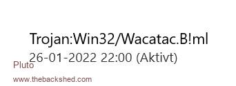

Posted: 08:00pm 26 Jan 2022
Got this when i tried to download MMBasic.zip.
/Fred

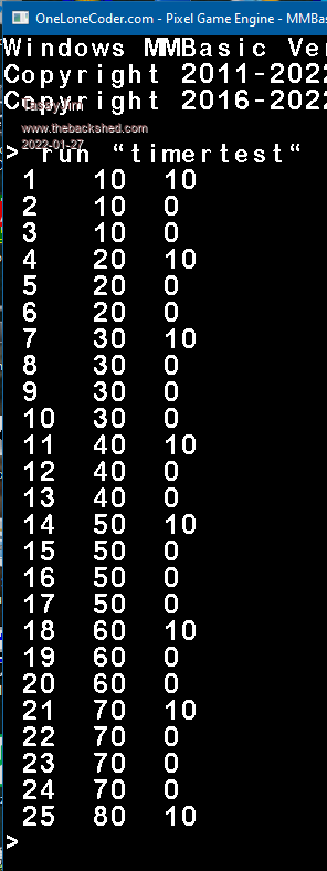

Posts: 6624
Posted: 08:01pm 26 Jan 2022
You are making good progress.
I am still seeing resolution problems with the timer.
Without any other programs running, the resolution is 10mS
Start any other program that has timing involved such as MMEdit V5 or VLC and the timing resolution changes to 15-16mS
I expect that it involves the timeBeginPeriod function (timeapi.h)from the Windows API
An extract:
  Quote  timeBeginPeriod function (timeapi.h)
Prior to Windows 10, version 2004, this function affects a global Windows setting. For all processes Windows uses the lowest value (that is, highest resolution) requested by any process. Starting with Windows 10, version 2004, this function no longer affects global timer resolution. For processes which call this function, Windows uses the lowest value (that is, highest resolution) requested by any process. For processes which have not called this function, Windows does not guarantee a higher resolution than the default system resolution.
Starting with Windows 11, if a window-owning process becomes fully occluded, minimized, or otherwise invisible or inaudible to the end user, Windows does not guarantee a higher resolution than the default system resolution. See SetProcessInformation for more information on this behavior.
I am running W10 and I think you are on W11.
The test program used:
 DIM INTEGER starttime, laptime, midtime
 starttime = TIMER
 midtime = starttime
 FOR k = 1 TO 25
   FOR n = 1 TO 10000
     x = LOG(12346)
   NEXT n
   laptime = TIMER - midtime
   midtime = TIMER
   PRINT k, TIMER - starttime, laptime
 NEXT k
Edited 2022-01-27 06:03 by TassyJim

Posts: 4386
Posted: 08:23pm 26 Jan 2022
/Fred
False positive - ignore.

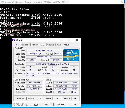

toml_12953
Joined: 13/02/2015
Posts: 731
Posted: 09:16am 27 Jan 2022
  Volhout said
  Plasmamac said  Hi,
Editor Mode - 16 % cpu
Run    Mode - 30 % Cpu
Grainbench 130201
I5 2500S  with 2,7 Ghz
its a litte bit faster as version 1  12700 Grains
looks fine here
I ran the grainbench on this i5 system: 175000 grains.
So the computation speed is top. While running grainbench it is 55% CPU load.
No idea why the text printing is slower. Maybe the throttle is removed from the graphics output routine, or my W10 machine is not HW compatible (driver mismatch on HW acceleration?). But I can watch youtube video's on this machine, so it is graphics capable.
WoW! On my 3.5GHz i9 system running Windows 11, I only get 119210 grains.
