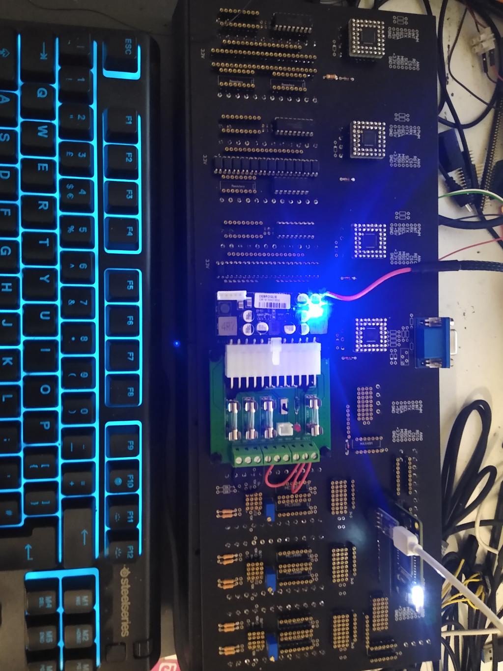

Posted: 03:55pm 27 Mar 2022
Been rock-solid for many days now. Bombarding two PicoMites from the Propeller @460KBaud.
I'm using Schottky diodes.
Feeling a bit guilty, relegating this awesome device to I/O expander but it's really cool. They are running watchdogs and are able to shut down the machine should anything go awry.
Craig

Posted: 09:06am 24 Nov 2022
It's working really well. Been hammering it for a few days now. Not a glitch
Four RP2040s talking to a Prop-2 @460K Baud:
Craig
