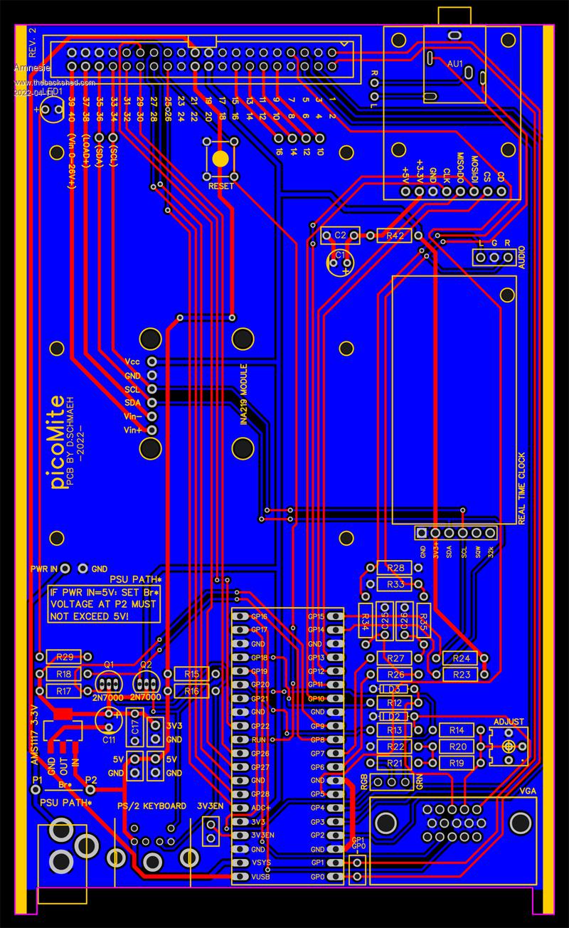

  lizby said  Neat case. Glad to see the 2x20 connector. What's it look like inside?
There is an piggyback PCB for a speaker and class d amplifier with EMI
-filter too. But I didn't want to take the case apart again for a picture.

  Amnesie said  But I didn't want to take the case apart again for a picture.
Nice work. What do you use the INA219 for--I've not seen that part used before?
Did you have a specific reason for running the ADC pins to the 2x20 connector and relatively few other pins (or had you run out of "other pins")?
Edited 2022-04-11 22:32 by lizby
Amnesie
Joined: 30/06/2020
Posts: 763
Posted: 01:16pm 11 Apr 2022
The INA219 is used on the SYSTEM I2C bus and works as an option to messure voltage and current of a some devices to visualize / plot it graphically on the VGA screen. Since it can handle voltages up to 26 volts and 3A it can be used with a lot of projects in mind. And it luckily was used before! There is even a whole port of an (arduino?) library here! I tested the code and it works pretty well.
I routed the ADC-pins, including direct sperate GND to the 2x20 connector in case I need the Pico to use it's internal ADC (which is not really good and has some flaws documented in the pico documentation) But maybe there are cases I need to process data as fast as possible, which is not possible via I2C-bus (minimal latency).
  Quote  relatively few other pins
I routed almost all available pins to the conncetor which are not used by the system components like SD card, VGA etc. because I don't need them "externally", the only exception is the SYSTEM I2C bus, which is also available on the 2x20p connector.
I dislike the fact that the original picoVGA-PCB has every single pin, even VGA pins routed to the 2x20 connector - for me - I don't see any reason to this for doing so. And this doesn't mean that it is useless. It is just not what I need and it is not such a routing nest (stray capacitance etc etc) with two additional footprints of the pico on the PCB. But again, I understand the point of beeing compatible with some Pico add-on-boards. I just designed the PCB to fit my needs :)
Edited 2022-04-11 23:40 by Amnesie
