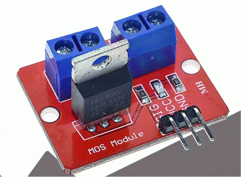

Posted: 12:18am 10 Jun 2022
In order to test various TO-220 N-CH logic level mosfets with the picomite, I cut the nearly useless IRF540 (up to 9V for full on--why don't they use IRL520 or IRL540 or other logic level mosfet?) off of one of these mosfet modules and soldered on a 3-pin female header:
The load was a nominal 50W 12V LED. This is my test program--full on for a second, off for a second, on for a second, off, then ramp at 1000Hz from 0 to 100% duty cycle and back down twice, then full on for a minute:

I tested FQU13N06TU, IRLB8743PBF, IRL540NPBF, IRLZ44N. All worked with 3V3 from the picomite with no problem.
(Note: I got an error message with PWM 0,OFF, which the manual says should work and should release the pin.)

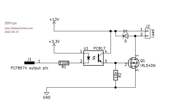

Posted: 11:14am 10 Jun 2022
I always use optocouplers with mosfets, I've never had a problem. like this taken from google

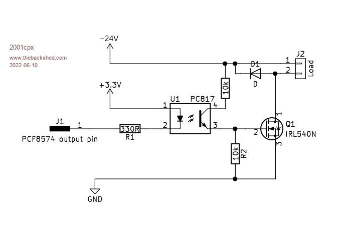

Posted: 01:15pm 10 Jun 2022
  2001cpx said  I always use optocouplers with mosfets, I've never had a problem. like this taken from google
That just feels better after experiencing the USB disturbance.
Would I simply add a voltage dividing resistor for 24V?

Posts: 9182
Posted: 01:37pm 10 Jun 2022
That should be ok. The IRL540N, for example, has a maximum gate-source voltage of 16V so you have to stay within that. You can probably drive the LED in the opto at two or three mA.
CaptainBoing
Joined: 07/09/2016
Posts: 2171
Posted: 01:46pm 10 Jun 2022
and you can miss out D1 if the load is resistive
