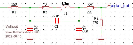

I appreciate the analog wizardry being discussed here - it's very educational - but I can't help but wonder if something like an MCP6004 plus a few simple passives would be simpler, more effective and maybe even more compact, especially if bulky inductors are involved.
Posts: 9027
Posted: 04:02pm 12 Jun 2022
It might be, but you still need board space for it and quite a lot of Rs and Cs. The problem is in getting a steep enough filter to get rid of 40kHz - which is very strong in the PWM output. You can't hear it directly, but it will cook the tweeters in your speakers. If you don't get the filter steep enough you hear the loss of high frequencies, particularly on things like cymbals which have a lot of high frequency content. A single, double or even three stage RC filter isn't steep enough. That's why we went for inductors. Volhout has experimented with smaller values (also physically smaller) but has found that a higher value works better (so far anyway!).
By removing the "standard" filter, plus two resistors and the little link block I found enough space to fit Volhout's circuit (including the 2.2mH inductors and two 5% capacitors) onto the (pretty crowded!) PicoGAME pcb. It doesn't take up all that much more board space really and needs no additional power supply filtering. I've changed other areas of the layout, but not to do with the audio. And I still haven't needed to stand resistors on end, and I've lengthened the distance between all the resistor holes by 1.7mm since version 1.4. :)

  Mixtel90 said  Volhout:
This is the inductor from RS.
Phil:
Useful tip...  Thanks.  :)
Mick,
The inductor you picked is a bigger one (body size) but can be used as wel.
For the best results with the RS inductor, use these values (theinductor you picked has higher Q factor, so it "peaks" more. Had to dampen it with capacitor values changes. With the 47n's it will also work, but with 33n/68n it is darn near perfect up to 18kHz.

Thanks, Volhout. Of course. if the RS component will fit so will a smaller one. That's a big plus.  :)
