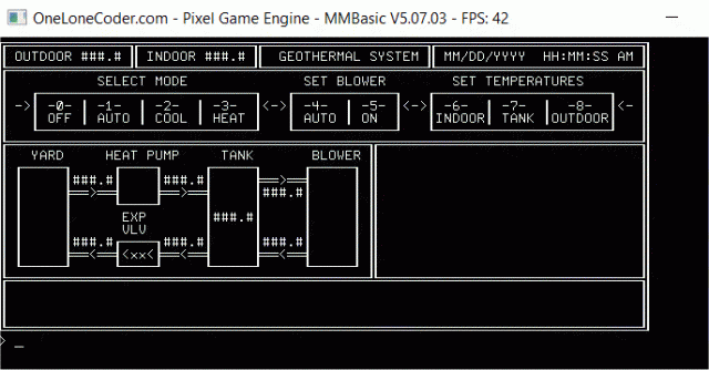

  lizby said  But with the conversion to ibm852 (one-time), you don't need to do anything if you have a file to read. Easy-peasy:
Very pretty (and fast), though you've got a couple of ? where the conversion isn't handling the junctions of double and single line box drawing characters - they aren't present in Code page 852 though they are in MMSCII. I think you need to try translating to Code page 437 perhaps using iconv on Linux.
Posts: 3885
Posted: 12:28pm 22 Jun 2022
> Code page 437
Thanks, Tom. I hadn't noticed those. Will fix.
But 437 rang a bell, and searching through my notes (every day for the past 13 years and 6 months), I find that on February 25, 2019, I used the text editor, Editpad, to convert from UTF-8 to CP437 ("with Editpad, convert, text encoding, encode UTF-8 to CP437"). I thought the problem sounded familiar.
