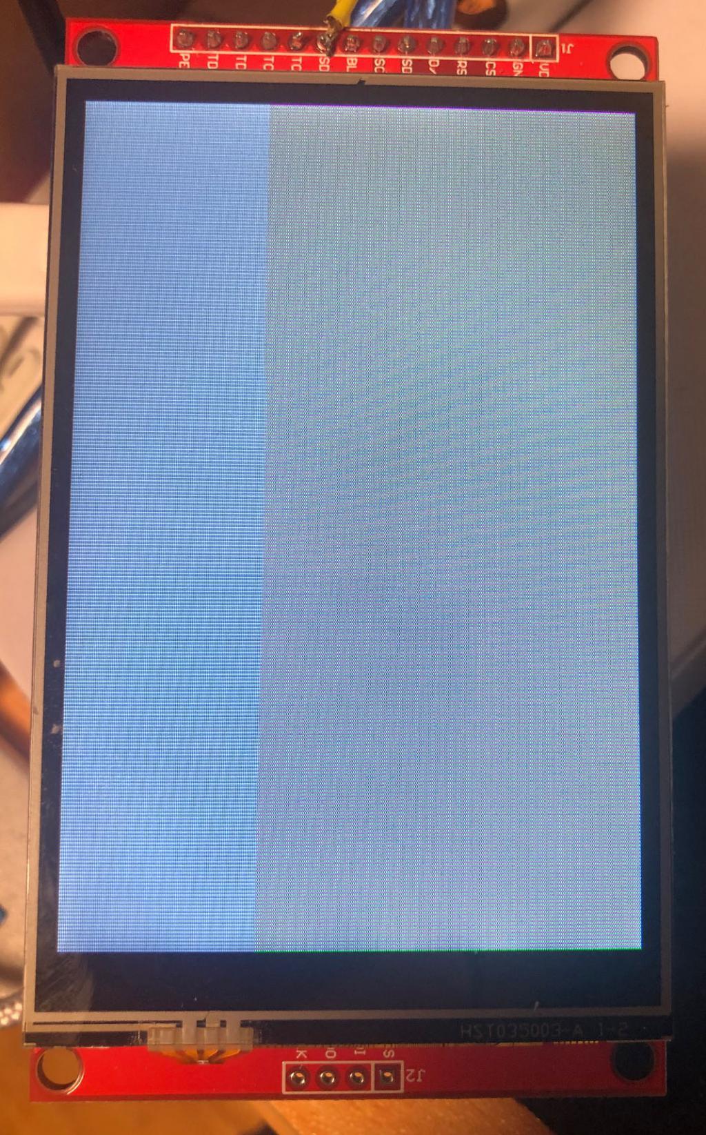

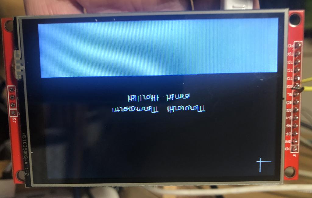

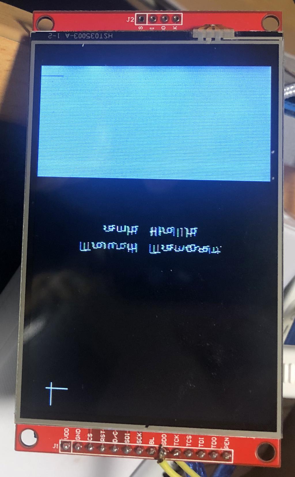

On power up after a second or so the screen goes white possibly missing every second row then goes through a clearing motion from the bottom and leaves about 1/3 of the screen white (every second row still missing)
I then Issue GUI CALIBRATE and I can see some form of not quite readable text and a part cross hair but no circle.
See attached Picture
That is the first time I have seen ANYTHING on the display.

Please try in landscape and make sure you are running at 125MHz

Mick, please also try CLS RGB(RED), blue etc. Looks like it is dropping pixels

That scribble is interesting. Inverted and written twice, 1 pixel down and about 3 horizontally. How strange. Is it trying to get neater text but missing?

It could be my picture taking but then I have seen the actual display so it is like it’s doubled and out of kilter, the screen also (at least in portrait) appears to be reversed horizontally as I know from working with other screens the cross hair would be at top left in GUI CALIBRATE and it is trying to print TOP Right.
I don’t know off hand if this is the same in Landscape but I suspect it is.
