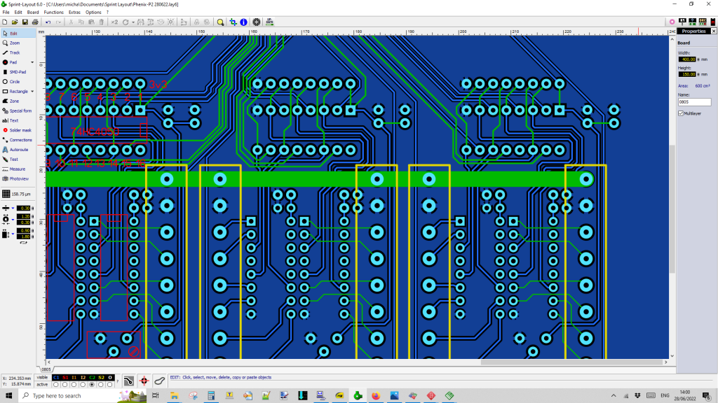

It's all great stuff. Right now, I'm not worried with my large board. SL is doing a great job.
Craig
Posts: 9182
Posted: 01:25pm 28 Jun 2022
Yay! I've created a PicoMite in DesignSpark without going any crazier than I was before! (Well, I don't think so...)
That's looking pretty, Craig. Be careful about the minimum track sizes and clearances that your chosen PCB house can handle. That applies to the width of lines used to draw silk screen characters too. I generally set the minimum to 0.15mm and normally work with a track width of 0.4mm if I can, which can carry about 1.4A using 1oz copper (best to derate it a little). Also, on a big board, make sure there is plenty of support or thin traces might break if it flexes. It may even be worth going for 2mm board rather than 1.6mm.
Tinine
Joined: 30/03/2016
Posts: 1646
Posted: 02:22pm 28 Jun 2022
Thanks Mick. We definitely think alike. I have always been thinking about the 2mm board and I need to get some screw holes around the 12-way connectors because they really need some oomph to pull apart. Board flex has been a consideration from the get-go

Posted: 06:50pm 28 Jun 2022
Here ya go Mick....
