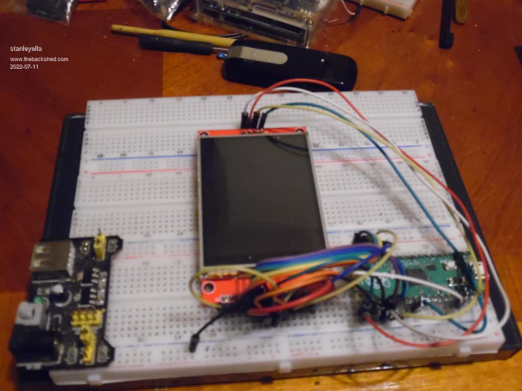

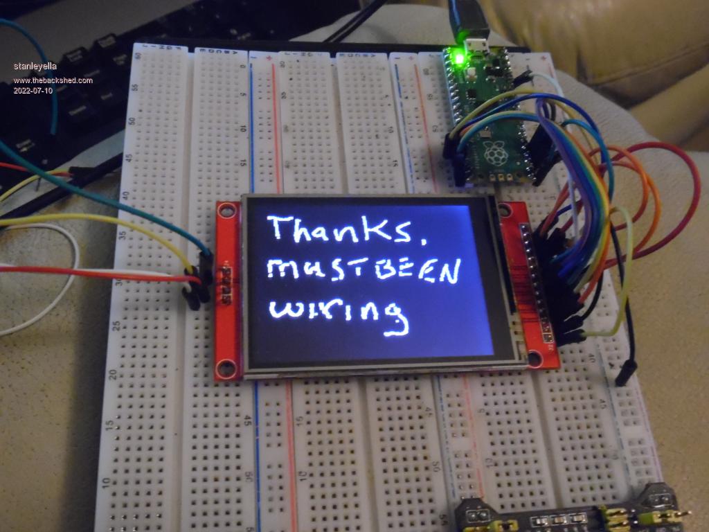

Thank you phil99. I wired it up as in the user manual and used the define gp but touch did not work until I rewired as per a previous suggestion. maybe the manual is wrong for setting up ili9341.
Display and touch are now working very nice. I'll check out your info. cheers.

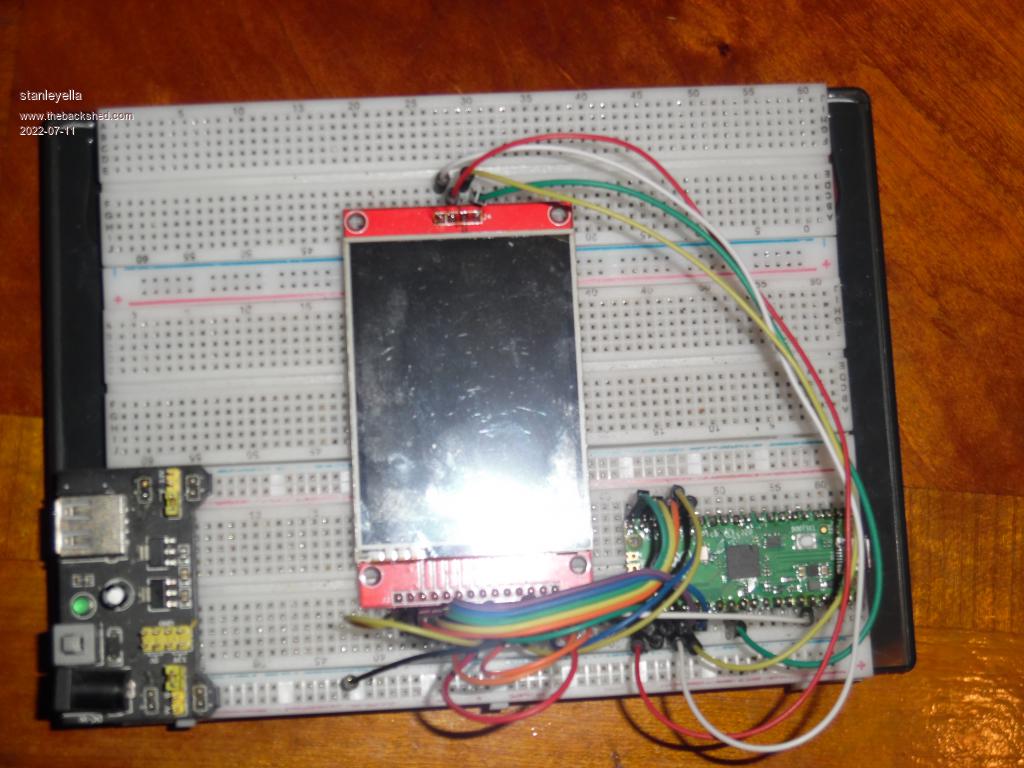

Posted: 11:18pm 11 Jul 2022
I got the 4 wires to the ili9341 sd card reversed but now if I type files it reads a sd card. Just got to figure how it's used.
Posts: 2807
Posts: 2807
Posted: 11:45pm 11 Jul 2022
sorry i posted twice. This is my first use of the ili9341 sd card slot. I thought it was just for the ili but seems it is a general sd card  for programs, anything.
Amazed. This is looking like a nice dev board. works well with ili.
