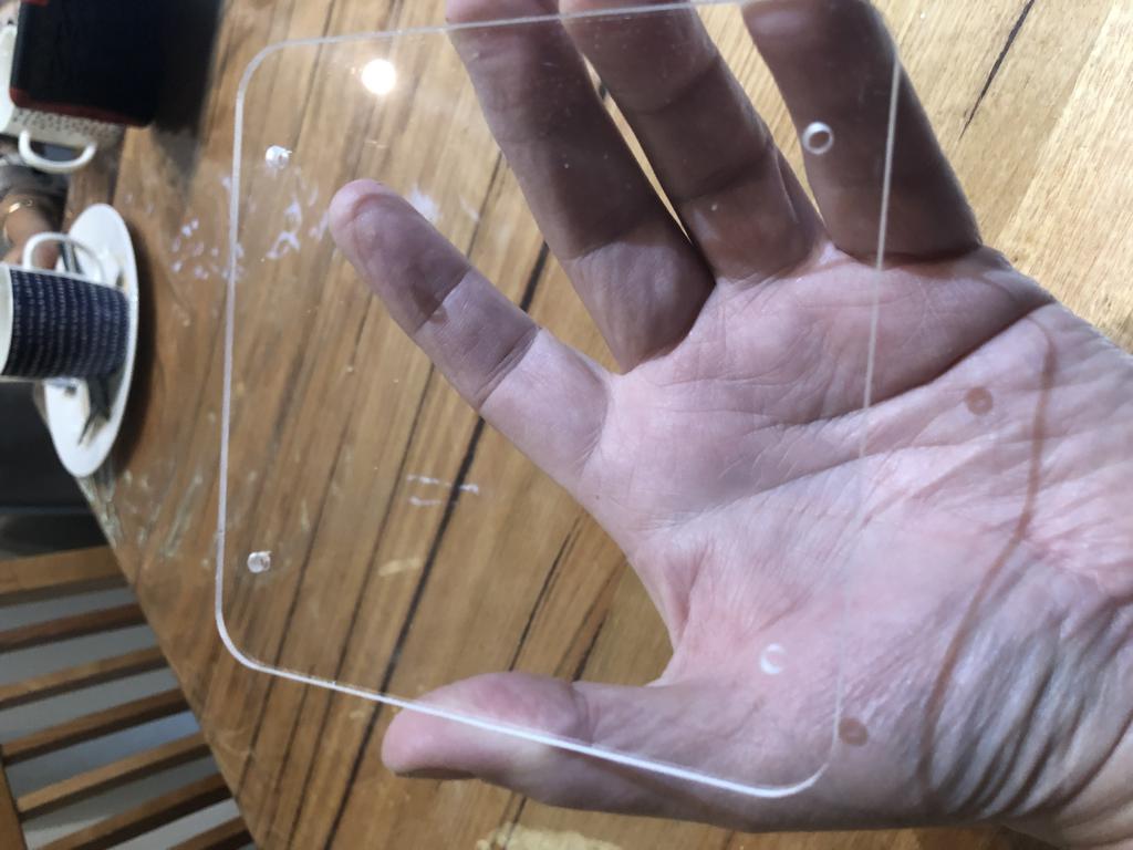

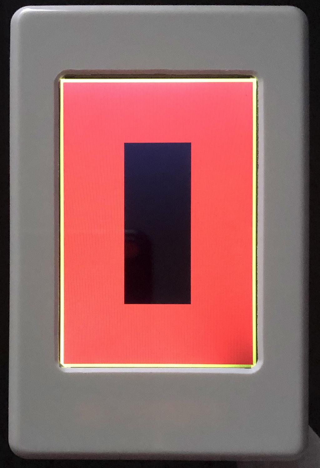

Here is my latest attempt at a fascia panel, I need to get some wet and dry sand paper to polish it up but I am very happy with the result.

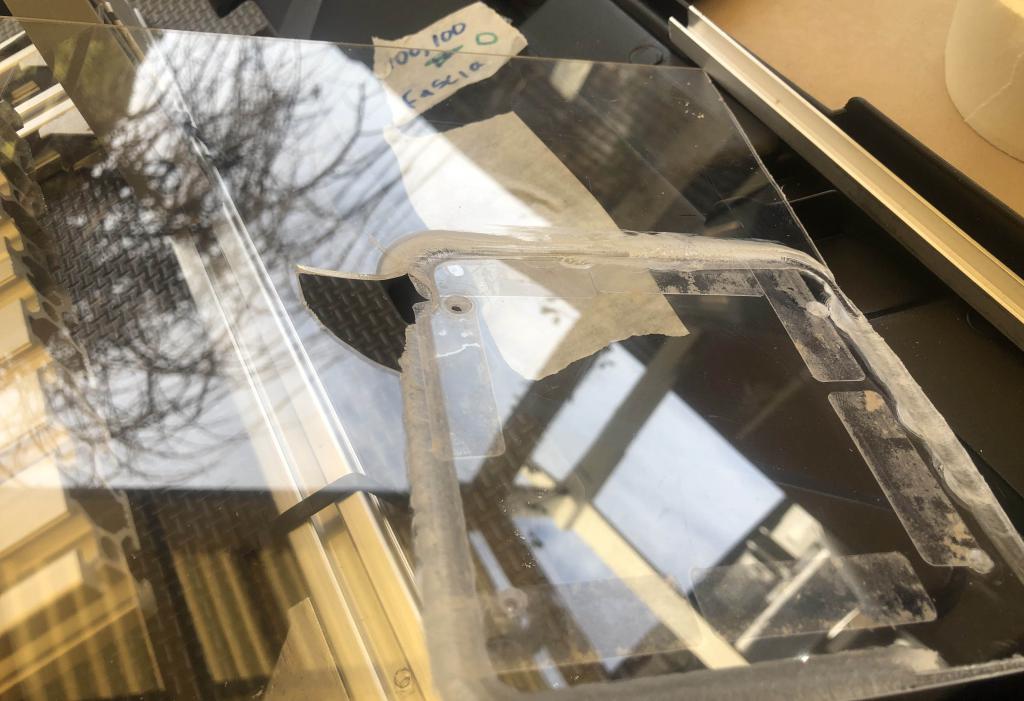

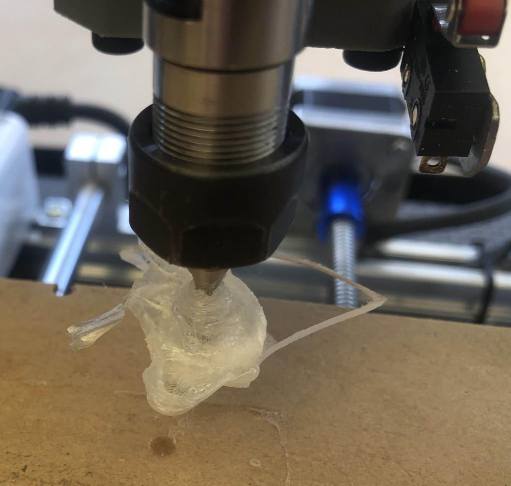

Now I tried cutting some acrylic for THWill, and boy did I learn something
This was my first result.
But new cutters came (from China), supposedly for Acrylic 4 flute with really steep spiral flutes and the shavings flew off perfectly.
This is the result
I am very pleased with them, They are now on the way to the UK for Tom to pick faults with.
To do those panels for Tom, I sped the X-Y up to 700 or 800 mm/s and took only 0.1mm depths (the melt job was 0.2mm depth and 200mm/s but a different but similar looking cutter)
Anyway getting very close to being able to do what I want and for a cheap CNC Mill I am very pleased.

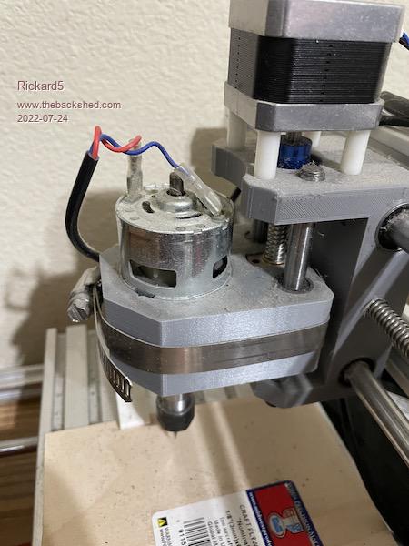

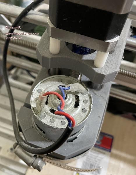

You were asking about the House Clamp on my 3018 SPINDLE MOTOR, THE 3018 has a known problem if you over torque the SPINDLE MOUNT it cracks, so the hose clamp is a good solution until I get the Gumption to design a program to make an Aluminum one on the HASS Machine center/ Also I need to Make an Aluminum Y Axis Antibacklash Nut

That makes sense, when I built my unit I remember something about mounting the head upside down so the head is pushed up by the spring as opposed to pushed down (which means the cutter can move up against the spring).
It made sense at the time.
