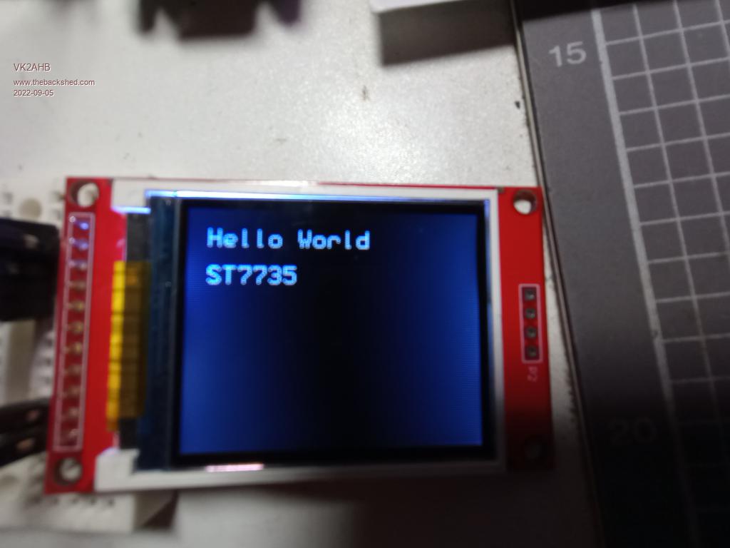

Hi Jim,
I am using the non_VGA firmware, PicoMiteV5.07.04.uf2
So when I did
1. OPTION SDCARD GP13, GP10, GP11, GP12 ** This is instruction on the VGA board
From the manual, they are CS, CLK, MOSI, MISO
So then I tried
2. OPTION SYSTEM SPI GP10, GP11, GP12 and got
Pin 14 (GP10) is in use.
Tried it the other way after RESET
3. OPTION SYSTEM SPI GP10, GP11, GP12  for CLK, MOSI, MISO
then
4. OPTION SDCARD GP13 for CS
5. OPTION LCDPANEL ST7735, L, 24, 25, GP11 for DC, RST, CS (Except my display doesn't have DC.
Message: Pin 15 is reserved on startup.
>>>OPTION LCDPANEL ILI9341, orientation, DCpin, RESETpin, CSpin
I'm using the ST7735, the ILI9341 is parallel according to someone and NG here.
6. OPTION LCDPANEL ST7735, L, 22, 21, 24 with MOSI pin GP11 (15) connected to SDA on the LCD, 21 on CS, 22 on *RS* and 24 on RST.
GUI TEST LCDPANEL did nothing.
> option list
OPTION LCDPANEL ST7735, LANDSCAPE,GP17,GP18,GP16
OPTION SDCARD GP13
Paul

  Quote  6. OPTION LCDPANEL ST7735, L, 22, 21, 24 with MOSI pin GP11 (15) connected to SDA on the LCD, 21 on CS, 22 on *RS* and 24 on RST.
Probably because RST and CS are the wrong way round - I assume you have also connected the SPI clock? RS==DC

  Quote  Message: Pin 15 is reserved on startup.
You were trying to use pin 15(GP11) for SYSTEM SPI and Lcdpanel CS.

Ah!, it was the SPI CLK that was missing! THe other pins were OK, maybe I wrote them down here incorrectly.  I now have masses of circles!
Many thanks. It's not at all obvious for us Newbies what needs to go where.

The thread strayed from the ILI9341 to the ST7735, the problems were the same in getting a display to work.
I got the SSD1306I2C working OK, then it was the ST7735 that was the challenge.
Finally got there.
