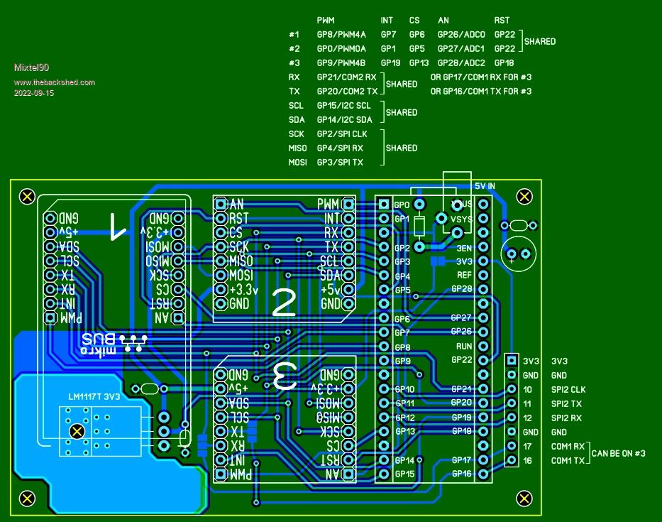

I'll have another look at Click, I think. I'd like to reserve one SPI for a display/SDcard though. I suppose anything else can go on the Click sockets (if I can wiggle the PCB tracks enough). COM, the remaining SPI and I2C might have to get shared if any more than a couple of Clicks are needed.
Does that sound ok?
They aren't really of much interest to me other than as a technical challenge. Without MMBasic support there's no point. ;)
It may take some time though, I'm in the middle of DIY with a bit of a deadline.

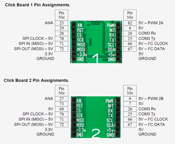

E-100:
Craig

It may be a lot of level shifting to fit in, for analogue as well as digital. It depends on the modules. I suspect that most will assume 5V systems. Also, level shifting on SPI *might* restrict the speed.

  Mixtel90 said  It may be a lot of level shifting to fit in, for analogue as well as digital. It depends on the modules. I suspect that most will assume 5V systems. Also, level shifting on SPI *might* restrict the speed.
I don't know how common 5v-only modules are. There is usually a jumper selection on the module and the default of the ones that I have used is always 3v3.
Craig
Posts: 9028
Posted: 12:39pm 14 Sep 2022
Good - I don't want to put level shifters in. It makes life complicated.  :)

So I guess you can do following:
1/ parallel connect all sockets for I2C and SPI (CLK/MOSI/MISO)
2/ parallel all sockets for 5V, 3.3V and GND
3/ Give the sockets individual CS+RST signals (DOUT), and AN (AIN)
4/ Whenever possible give individual RX and TX
Since pico is limited to 3 x AIN, we should be able to support 3 sockets
Edited 2022-09-15 01:05 by Volhout

Oh, I should've remembered this. They do have level translators. But I guess that they are just covering all bases:

Imagine those headers that stick out on the other side (for the Pico). I could plug my Waveshare display into it, right? But now the Click sockets stick out to one side instead of behind the display.
No clue at this point what I/O clashes there would be.
Craig
Posts: 9028
Posted: 05:43pm 14 Sep 2022
In theory...
by default #3 shares COM2 with #1 and #2. You have SPI2 to use for the display, with GP16 for DC and GP17 for RESET. Tit CS low as there's only the display on the bus. That's for a basic ILI9341. No backlight control, touch or SD card.
Alternatively, use COM1 to connect to another PicoMite connected to the display of your choice.  :)  You could also use one or two of the SPI lines as interrupts, I suppose.
In your case you could connect COM1 to a cog.
You could also communicate with a second PicoMite using SPI, so #3 could use COM1.
Unfortunately there's a finite number of pins, which is why #1 and #2 share a RST line. I suppose I could have put GP25 into use...
It's not designed as a backpack. The fixing holes are wrong, as is the overall size. You'd be better off running a short SPI or COM lead to a backpack board as there's not enough IO left to be useful..
Edited 2022-09-15 03:46 by Mixtel90

In the experimenters board the pico was not socketed. When you rotate click sockets 2 and 3 they could overhang the pico when mid or large sizeclick modules are used.
Maybe you could save 1 pin by sharing all 3 reset lines, that would not impact funtionality.

Should there be a single reset button that simply resets everything or are the Click modules really intended to be reset individually as needed?
The Click "specification" is poor, to say the least. It goes into fine detail about module sizes, types & positions of screen printing etc. but is extremely sparse on anything to do with how the things are supposed to work. There isn't even a pin by pin definition of what they do or even the range of voltages and current limits allowed for a module. Yes, you can make your own module to the "open" specification but the chances of it working with anything else could be remote.
EDIT:
As I can't find a definitive spec that's what you're getting - a single reset button that does the lot. That way I get two spare I/O which are on the GPIO header. Useful for connecting a display.
I've turned #2 and #3 round and also rotated #1 through 180 degrees as it made the traces easier. It'll now take large modules in #2 and #3 positions and medium in #1, all within the footprint of the pcb.
