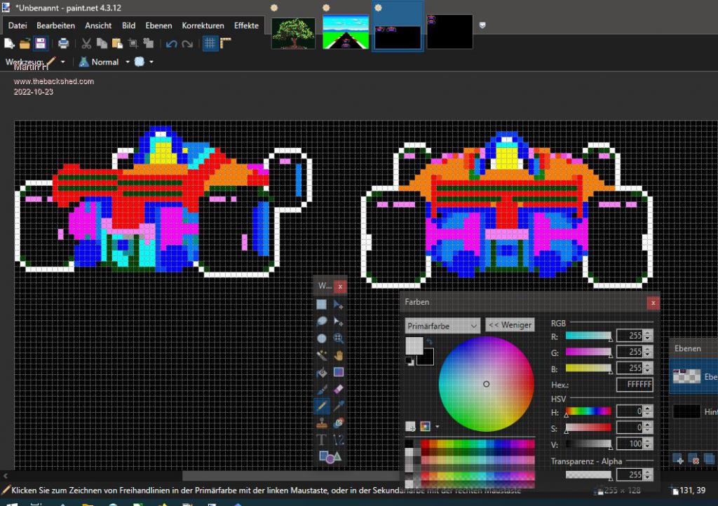

meanwhile I prepare the next sprites

i ve done some little changes in your code and added the new Protagonist.

compressing the Sprite Data
--- Mart!ns little Toolbox
So far I've used a text editor to search and replace repeating parts of the Sprite Data strings with the compressed form.
which is quite laborious.
Example :
find "0000000000000000" replace with "GF"
find "000000000000000"  replace with "GE"
find "00000000000000"   replace with "GD"
find "000" replace with "G2"
and that for all 16 colors.
You can do something like this 2-3 times, but it's boring and a real punishment. So I thought, the pico can do that much faster and with less effort so let him do the work

there is certainly still something to optimize, but it works.
the following compressed output resulted from the data of the program above

in combination with the sprite read and expand routine you can save quite a few kilobytes.
happy pixel counting
