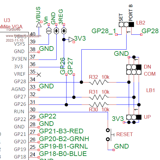

  thwill said  Those are not the raw NES serial values, the "ctrl" library maps the outputs of all controllers onto the wider range of outputs returned by "Wii Classic Controller" as that is the one standard that the MMBasic manuals document.
     2048 = Button A
     2176 = Button A + Up
This even tells us what the hardware issue probably is, if these are being read when the test program is configured to read ports A & B as Atari joysticks and no Atari joysticks are connected then pins GP14, GP15 and GP28 are all shorted to ground.

Looking at the 2.0 schematic, where is the pull-up resistor on GP28 when attaching an Atari joystick to port B ?
Edited 2022-11-10 07:35 by thwill

Posted: 09:57pm 09 Nov 2022
Looks like it depends on LB1 whether it's pullup or down.
Bill
Posts: 9329
Posted: 10:21pm 09 Nov 2022
That's correct, Bill. Set it to UP and it will pull GP28 up. With link LB3 closed pin 1 is also pulled up, so it becomes the Atari joystick UP pin.
In theory anyway...  :)
Posts: 4410
Posted: 11:04pm 09 Nov 2022
Ah, I was only looking at the GP28 on the DB9 connector part of the schematic.
Anyway that probably answers why Martin is getting the unexpected Atari UP on port B, the jumpers are set wrong.
That just leaves both ports unexpectedly reporting Atari A/FIRE. Martin, I'm wondering if you've systematically installed the wrong resistors or capacitors connected to both GP14 & GP15 (pin 6 on the DB9s). These are also the 3V3 supply pins when using NES controllers so that would explain why they aren't working either.

Posted: 02:53pm 11 Nov 2022
  thwill said
Try this test program: ctrl-test-pmvga.zip
so, NES @ B Atari @ A both ok...
I missed 2 150R Resistors under the Pico, so it wasn't obvious
Thank you all for your Support.
