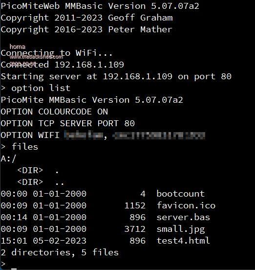

Posted: 05:26pm 05 Feb 2023
Copy the 4 files from the ZIP file with:
> xmodem receive "filename"
and then into TeraTerm file Xmodem SEND the matching file.
In the screenshot still the OPTION List.

Ok, working now. Thank you very much for this.
Posts: 12002
Posted: 06:00pm 05 Feb 2023
You can also have the files on an SDcard - just pre-pend "B:/" before the filename - - tested and works just as well

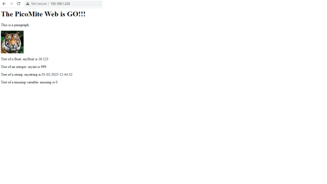

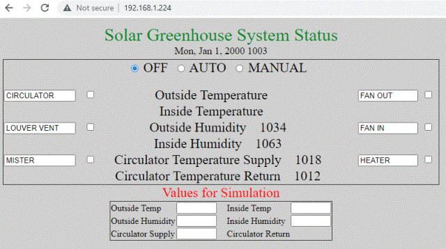

Ok, this is now being served by the PicoMiteWeb:
A long way to go before it's functional, since I don't know how to interact with it. But very good progress.
I've subsequently seen how to get the date right with "WEB ntp -5", but in my formatting, I don't have the time right or the day of the week.
Lots of potential here.

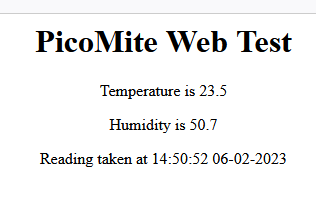

Posts: 6624
Posted: 03:58am 06 Feb 2023
With a slight modification to Peters code, a simple weather station is born.
Page refreshes ever 15 seconds and the DHT22 is read every 3 seconds to allow for any bad readings.
BAS file:

Result:
The system is undergoing a soak test.
