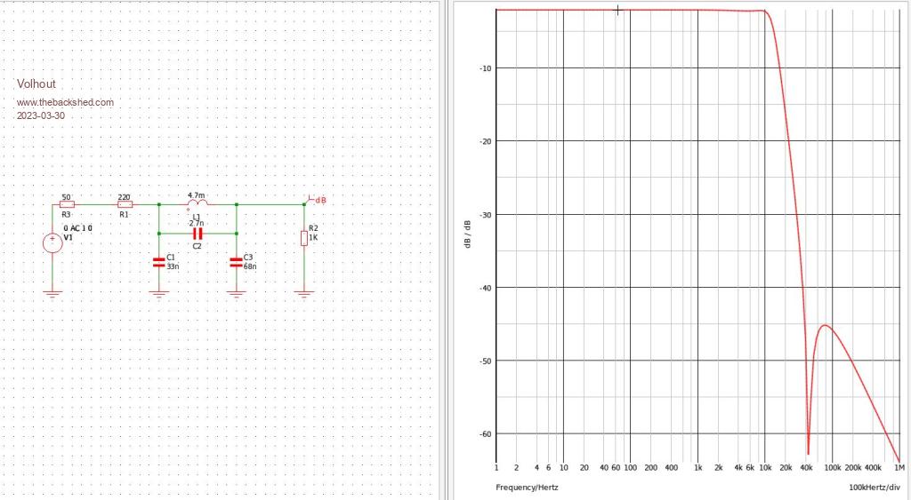

Guy's, please cool down. You are free to design your own filter.
This is what my simulation shows, and it's pass band (the audio you should hear) has been verified by measuring frequency response using the PLAY TONE.
Note this filter is 14kHz (not 20kHz) since that was giving the best results for me.
The 44kHz is really far down in my test setup, and my 2 Picomite VGA 1.7 boards.
The 1k termination is not dominant, you still get acceptable frequency response when terminating with the input of an audio amplifier (10k or 50k) and with a headset (600ohm or 32 ohm).
P.S. if you want to build, or simulate yourself, note that the inductor is 4.7mH (mili Henry), not microhenry....

... and it sounds *very* nice to my ears. :)
Many thanks. :)

Thanks Volhout, that is the sort of response curve that I was expecting. I notice that you do not include the 10 ohms effective series resistance on the inductor that should broaden the notch and reduce it's depth. To what extent?
This topic has always included a lot of 'I think' and 'IIRC' and 'IMHO' and my concerns that I raised before still exist (to me at least).
Many seem to believe that it is vital to remove as much of the 44.1kHz as possible with warnings of cooking MOSFETs and tweeter damage. But no with proof.

@Volhout, your LC filter values seem the by set in stone now but other values will resonate at the same frequency. For instance:
2.7mH and 4.7nF = 44.68kHz the same frequency.
3.3mH and 3.9nF = 44.36kHz even closer to 44.1kHz
Other values of inductance would also work but may need non standard values of capacitors (two capacitors in parallel)
Do you foresee any problems using other values?
