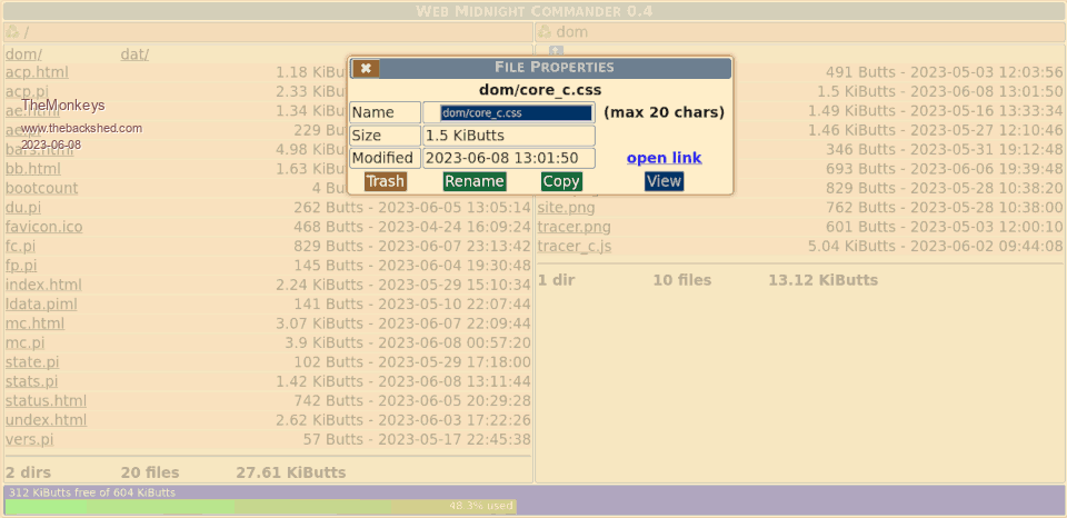

Execute has broken.
From my console log
0?fnw=/.trash/update.bas
1?fin=update.bas
2?act=mv
11:34:36 Rename "update.bas" As "/.trash/update.bas"
[228] Execute tmp$
Error : Only single statements allowed
The code in question:
logIt(tmp$,con+lgf,3) ' log file activities
Execute tmp$
The first line prints time$+tmp$
This code was rock-solid until I updated to b2
Also, it now requires
option tcp server port 2040
after this error
as it seems to lose connectivity.

Posted: 11:28am 06 Jun 2023
Hi Tom, it's roughly this.
qt$=Chr$(34)
If act$<>"" Then
 Select Case act$
   Case "xm"
     fact$="XMTrim("+qt$+fin$+qt$+")"
   Case "mv"
     fact$="Rename "+qt$+fin$+qt$+" As "+qt$+fnw$+qt$
   Case "cp"
     fact$="Copy "+qt$+fin$+qt$+" To "+qt$+fnw$+qt$
   Case "rm"
     fact$="Kill "+qt$+fin$+qt$
   Case "dl"
      dl%=1
      fact$=""
 End Select
 tmp$=fact$
 If tmp$<>"" Then
   Execute tmp$
 EndIf
EndIf
Bear in mind that this code worked perfectly until I updated from 5.0707b0 to 5.0708b2.

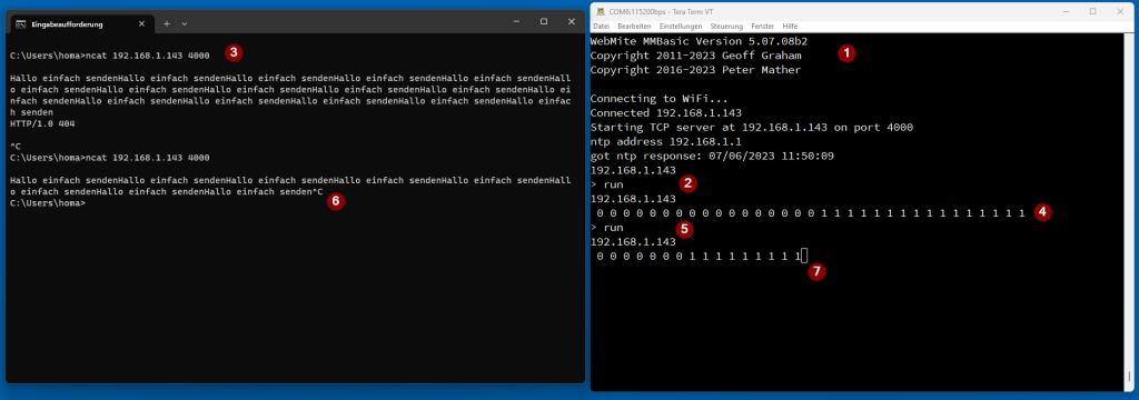

Posted: 10:04am 07 Jun 2023
Oh sorry, I had overlooked that!
  matherp said
You are not using the code in the way intended which is for the client to make a single request and then receive an answer after which it should close the connection.
If you want to keep a connection open then use the new WEB TCP SEND command which doesn't automatically close the connection at the server end
Yes, I have understood this as far as it goes. But my CLIENT (e.g. home-assistant.io) gets the IP of the WebMite entered (socket://192.168.1.77:4000). Unfortunately, it only establishes the connection via TCP and then waits for data from the service (in my case, this should then be the WebMite, I would like to send processed data from a sensor here, for example...).
So, as I understand it, WebMite is then the TCP server and reacts to a request, but only receives the interrupt if something has been sent (my problem!) and crashes when continuing to send if the CLIENT (e.g. home-assistant.io) terminates the connection for whatever reason.
My TEST code:
Dim buff%(4096/8)
Print MM.Info(ip address)
LongString APPEND buff%(), "Hallo einfach senden"
senden=0
WEB tcp interrupt webinterrupt
Print senden;
 If senden=1 Then
   WEB TCP send 1, buff%()
 EndIf
Pause 1000
Sub webinterrupt
  senden=1
End Sub
1) Start the WebMite
2) Running the programme
3) Client establishes connection (test with ncat instead of home-assistant.io) - ENTER necessary before WebMite starts sending!
4) Exit WebMite (Ctrl-C) ==> no problem Connection ends cleanly, see message in CMD window
5) 2nd test, restart the test programme - ENTER necessary before WebMite starts sending!
6) This time the connection is terminated by the CLIENT (ncat).
7) WebMite crashes, it does not notice the termination. Or what am I doing wrong here?
So the two points are, how do I get the status that a connection exists and how do I know that I am no longer allowed to send.
Matthias

Posts: 12002
Posted: 07:17am 13 Jun 2023
  Quote  Actually, the only question I have is how to get the status of a TCP/IP connection in Basic?
You can't. The concept is that the server responds to an incoming request for data. If there is an incoming request then it is axiomatic that a connection exists. After the server responds to the request it, for all commands except the new WEB SEND, closes the connection returning again to a known state.
