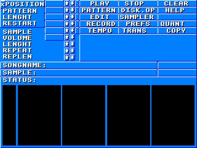

for someone who dares to write a traker for the Pico. Here is my suggestion for the GUI (inspired by the ATARI NOISETRAKER)
this does nothing, just draws the GUI and waits for ESC to be pressed.
Dim integer COL(15):Restore colors:For f%=1 To 15:Read COL(f%):Next f%
MODE 2:Font 9:CLS COL(11)
DTEXT 0,3,"xPOSITION":DTEXT  4,14,"PATTERN":DTEXT 4,24,"LENGHT"
DTEXT 4,34,"RESTART":DTEXT 4,48,"SAMPLE":DTEXT 4,58,"VOLUME"
DTEXT 4,68,"LENGHT":DTEXT 4,78,"REPEAT":DTEXT 4,88,"REPLEN"
DTEXT 4,102,"SONGNAME:":DTEXT 4,114,"SAMPLE:":DTEXT 4,126,"STATUS:"
Frame 0,0,72,44:Frame 0,124,320,116
DTEXT 146,2,"PLAY   STOP    CLEAR":DTEXT 132,13,"PATTERN DISK.OP  HELP"
DTEXT 146,24,"EDIT  SAMPLER":DTEXT 140,35,"RECORD  PREFS  QUANT"
DTEXT 142,46,"TEMPO  TRANS    COPY"
For f%=0 To 88 Step 11
If f%<66 Then Frame 73,f%,30,10
Frame 104,f%,8,10:Frame 113,f%,8,10:DTEXT 106,f%+1,"}":DTEXT 115,f%+1,"{"
If f%<55 Then
 Frame 122,f%,6,10 :Frame 129,f%,63,10:Frame 192,f%,64,10:Frame 256,f%,64,10
EndIf
Next f%
Frame 0,100,255,11:Frame 256,100,64,11:Frame 0,112,255,11:Frame 256,112,64,11
Frame 129,55,198,44:frame 0,1,8,12
Box 4,138,22,98,,0,0:Box 29,138,70,98,,0,0:Box 101,138,70,98,,0,0
Box 174,138,70,98,,0,0:Box 246,138,70,98,,0,0
do:n$=inkey$:loop until n$=chr$(27)
Sub Frame xx,yy,ww,hh
  Line xx+1,yy,xx+ww-1,yy,,COL(7):Line xx,yy+1,xx,yy+hh-1,,COL(7)
  Line xx+1,yy+hh,xx+ww-1,yy+hh,,COL(1): Line xx+ww,yy,xx+ww,yy+hh-1,,COL(1)
End Sub
Sub DTEXT xx,yy,TE$
 Colour 0:Print @(xx+1,yy+1,1)TE$:Colour col(7):Print @(xx,yy,1)TE$
End Sub
