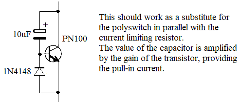

I have ordered a couple of parts to do sum testing of a 24vDC powered unit driving 24vAC solenoid.
i am going to use a AQZ102 SSR
and a 0603L001/60YR  Poly-Fuse  on paper it should work.
Information is a bit sparse on how long the  poleyfuse will last for in a cyclic application so i think i will mount them on a daughter card as a consumable component.
and do the design so i can revert to a fet and 555 if the polyfuse prove to be troublesome.

It was to use it as a switch to provide a 24vDC pulse to the 24VAC solenoid and then trip and supply a low holding current to the solenoid.
The parameters of the polyfuse
Voltage - Max 60V
Current - Hold 10 mA
Current - Trip 50 mA
Current - Max 40 A
Time to Trip 1 s
Resistance - Initial (Min) 15 Ohms
Resistance - Post Trip (Max) 100 Ohms

  pd-- said  It was to use it as a switch to provide a 24vDC pulse to the 24VAC solenoid and then trip and supply a low holding current to the solenoid.
That is unusual and I could see that the device might wear out.  I would use a spare output from the WebMite driving a FET which would switch in a current limiting resistor in the common line.  It would take a small change to the BASIC program but nothing serious.

Polyfuses have a wearout
Polyfuse Lifetime
This may be better
Switching PTC
Edited 2023-09-09 20:13 by bigfix

The cost of eight small 24VDC solenoids isn't exactly immense. Sometimes it's better to simply admit defeat, pay up and get the right tool for the job. :)
(Cheap unless you want the posh, industrial brass body ones anyway! The Shakitobitsi Electronics (China) Company ones would probably have to be protected in something, but at eight quid...)
Edited 2023-09-09 20:39 by Mixtel90
pd--
Joined: 11/12/2020
Posts: 122
Posted: 10:56am 09 Sep 2023
24VDC 25mm solenoids are listed at $59 each so $472 for the set of eight.
And then im left with a box of AC solenoids.
There only going to be used once a day at most for four months of the year
ill do sum testing and se how they go
