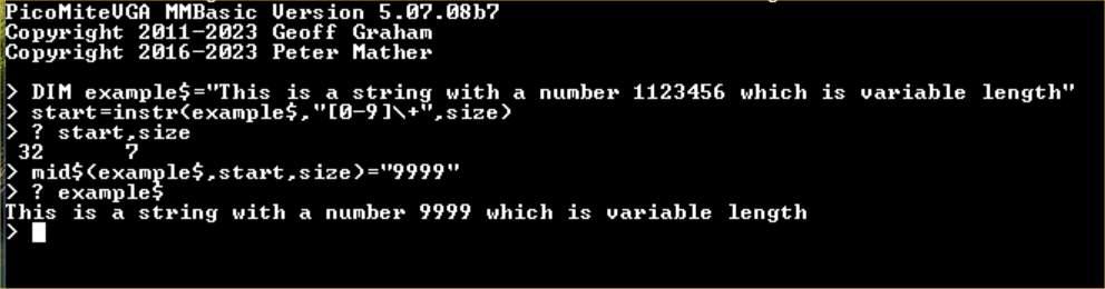

  matherp said  Thanks for the documentation. We will include it in the next manual.
Another good use is to substitute sub-strings in strings using the new flexibility in the MID$ command
e.g.
