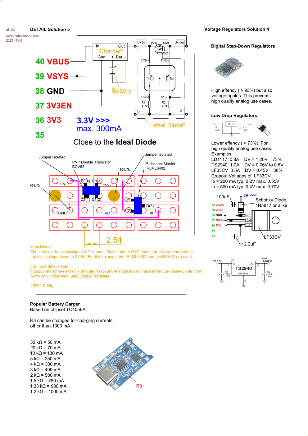

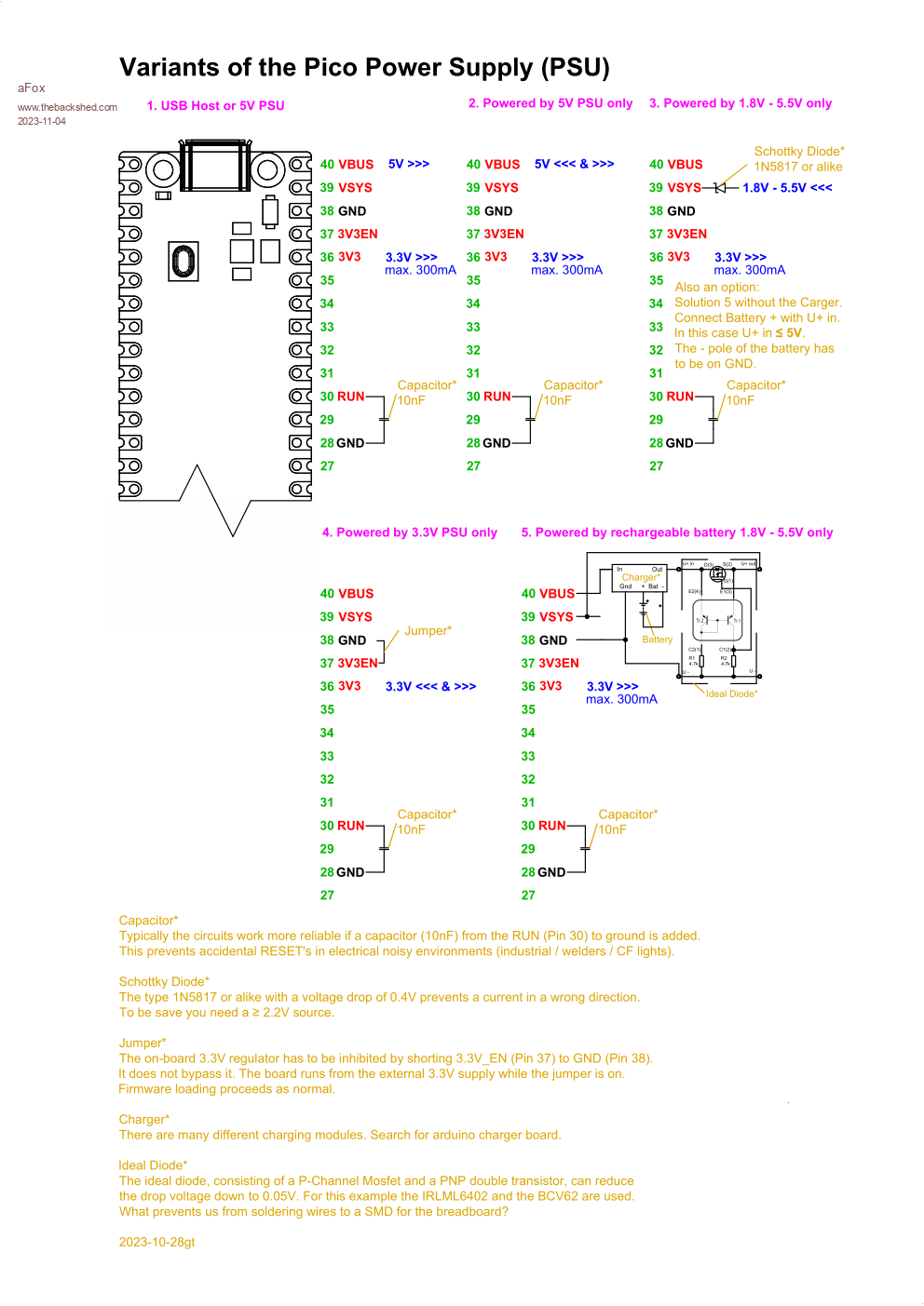

Posted: 01:57am 04 Nov 2023
Hi
Here is the final version, if allways is ok.
Many thanks for your help.
Pico Power Supply Cheat Sheet 2023-11-04.zip

Posted: 09:24am 04 Nov 2023
Thanks Gregor. :)
It's a useful document to have around.
