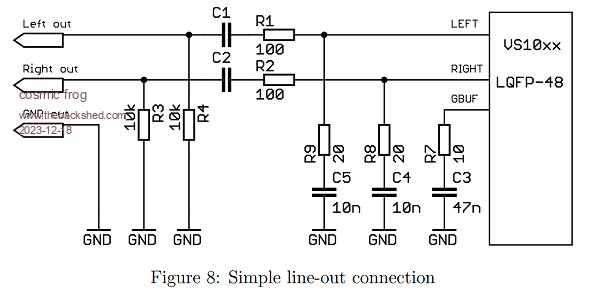

I just looked at the schematic again.  I do have a GBUFF signal in the audio output.
Maybe I blew out the audio output circuit when I connected it to my bluetooth speaker. I have about 4 of these boards. I will try another. thank you for the advice.

crazycloud
Joined: 20/08/2023
Posts: 43
Posted: 06:05pm 17 Dec 2023
thank you everyone. I got it working. the sound quality through crystal type high impedance headphones is awesome!  I gave it a 100k mp3 file to play.  It doesn't seem to play the entire file, BUT I GET SOUND!!

cosmic frog
Joined: 09/02/2012
Posts: 311
Posted: 06:16pm 17 Dec 2023
  crazycloud said  now I have to figure out how to input it into an amplifier without blowing up the circuit.  Maybe couple it into 2 high impedance audio transformers?
Have you tried this -
The Ground should come from the "-" connection of the power supply DO NOT USE GBUF.
Dave.
crazycloud
Joined: 20/08/2023
Posts: 43
Posted: 06:19pm 17 Dec 2023
I just saw that online, thank you. my next project.
