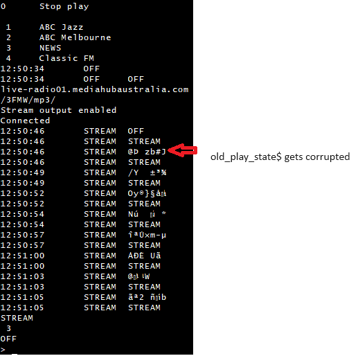

Posts: 6632
Posted: 02:06am 21 Feb 2024
I think we have a corruption problem.
Every 3 seconds, a string variable old_play_state$ gets corrupted.
If I change the order in the DIM statement line, no corruption (or none noticed yet)
  Quote  > OPTION LIST
WebMite MMBasic Version 5.09.00b2
OPTION CPUSPEED  250000 'KHz
OPTION WIFI eeeeee, **********, PICOggggggggggggg
OPTION TELNET CONSOLE ON
OPTION AUDIO VS1053 GP10,GP11,GP12,GP13,GP14,GP15,GP9', ON PWM CHANNEL 5
The program:
 OPTION ESCAPE
 OPTION EXPLICIT
 OPTION DEFAULT NONE
 DIM url_list$(10,2)
 DIM INTEGER n
 DIM k$, old_play_state$, play_state$
 ' Dim k$, play_state$, old_play_state$ ' this variable order causes corruption
 DIM buff%(4095),w%,r%
 ' fill the favorites list
 'cls
 PRINT CHR$(27);"[H";CHR$(27);"[2J"
 PRINT 0,"Stop play"
 PRINT
 FOR n = 1 TO 9
   READ url_list$(n,1),url_list$(n,2)
   IF url_list$(n,1) = "END" THEN
     url_list$(n,1) = "" : url_list$(n,2) = ""
     EXIT FOR
   ENDIF
   PRINT n,url_list$(n,1)
 NEXT n
 DO
   k$ = INKEY$
   SELECT CASE k$
     CASE "x","X" ' quit program
       endplay
       EXIT DO
     CASE "0" ' end play
       endplay
     CASE "1" TO "9" ' change stream
       endplay
       PAUSE 500
       n= VAL(k$)
       listen url_list$(n,2)
     CASE ELSE
   END SELECT
   PAUSE 10
   play_state$ = MM.INFO$(SOUND)
   IF INSTR(" OFF PAUSED TONE WAV FLAC SOUND STREAM ",play_state$) THEN
     IF old_play_state$<>play_state$ THEN
       PRINT TIME$,play_state$, old_play_state$ ' corrupted data
       old_play_state$ = play_state$
       PRINT TIME$,play_state$, old_play_state$ ' should be equal
     ENDIF
   ENDIF
 LOOP
END
SUB listen url$
 LOCAL q$, a$, strm$, k%
 IF UCASE$(LEFT$(url$,7)) = "HTTP://" THEN url$ = MID$(url$,8)
 r% = 0 : w% = 0
 k% = INSTR(url$,"/")
 a$ = LEFT$(url$,k%-1)
 strm$ = MID$(url$,k%)
 PRINT a$
 PRINT strm$
 q$="GET "
 INC q$, strm$
 INC q$," HTTP/1.1\r\n"
 INC q$,"Host: "
 INC q$,a$
 INC q$,"\r\nConnection: close\r\n\r\n"
 PLAY STREAM buff%(), r%, w%
 WEB OPEN TCP STREAM a$,80
 WEB TCP CLIENT STREAM q$, buff%(), r%, w%
END SUB
SUB endplay
 IF MM.INFO$(SOUND)<>"OFF" THEN
   PRINT MM.INFO$(SOUND)
   PRINT MM.INFO$(TCPIP STATUS)
   PLAY STOP
   PAUSE 100
   ON ERROR SKIP
   WEB CLOSE TCP CLIENT
 ENDIF
END SUB
 ' Display name , url
myList:
 DATA "ABC Jazz","live-radio02.mediahubaustralia.com/JAZW/mp3/"
 DATA "ABC Melbourne","live-radio04.mediahubaustralia.com/3LRW/mp3/"
 DATA "NEWS","live-radio02.mediahubaustralia.com/PBW/mp3/"
 DATA "Classic FM","live-radio01.mediahubaustralia.com/3FMW/mp3/"
 DATA "END",""
Could this help explain some of the distortion when switching streams? I have not noticed the distortion yet.
Edited 2024-02-21 12:09 by TassyJim
