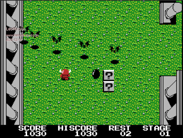

Hello everyone
I released the new version, in which I implemented the power-ups.
There are some bugs I'm still working to fix, such as the lack of SFX when the player is with the contact explosion power-up.
The last game's source code is committed to the project git repo.

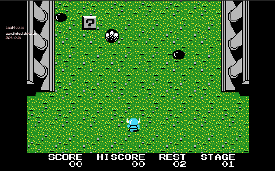

Weapon chrystals in development
Soon, Popolon will have new and more powerful weapons to fight against the enemies.

I don't know if this is good or bad, I hope it is good
Soon I will release the version where we can update the weapon.
What is missing to be implemented:
1) Shied blocking enemies shots
2) Player receiving a hit
3) The stage boss
4) Stage transition
5) Main menu
6) The other 7 stages with their creatures and Bosse
7) The game ending
8) Support for gamepads

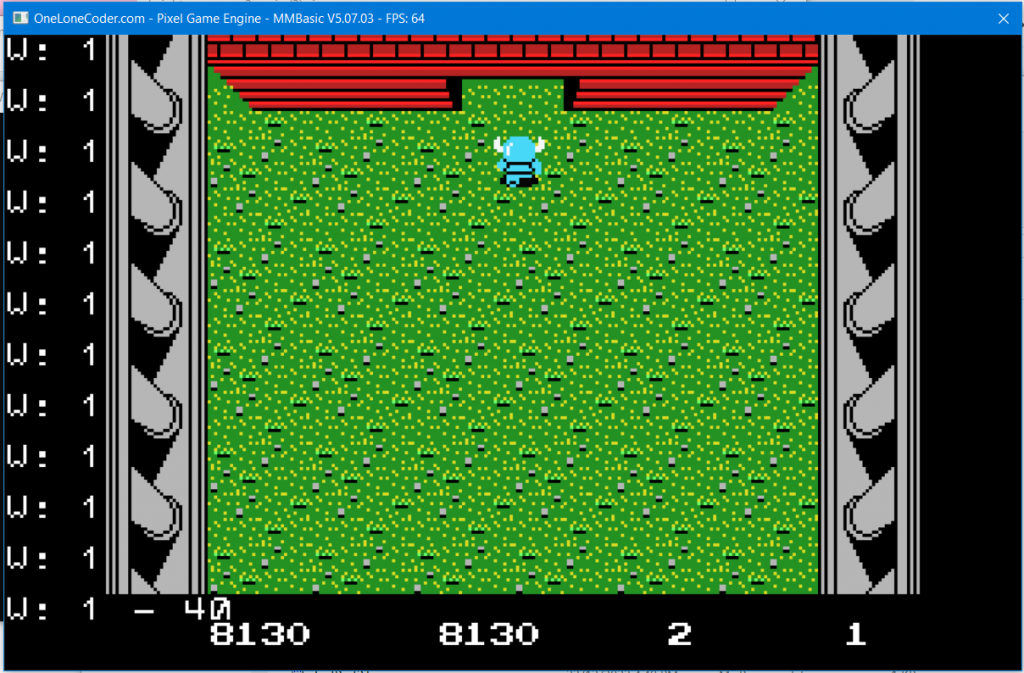

Did I say a was a geriatric? Not sure that I did try the latest version of the game now but I just did on the latest MMB4W and saw some funnies on the left of the screen if that helps.
I can go no further up than here.
EDIT: This is DEFINATELY the latest of each:
It's difficult to know which version is which. Maybe I shouldn't keep the old ones.
The "funnies" are not there now but the game just crashed as you can see.
No error reported.
Bill

Posted: 03:02am 27 Dec 2023
Bill
Thank you for testing the game.
That weird text on the left side of the screen was my fault. I committed a debug print. I will remove it in the next version.
There is no boss implementation yet, so the stage ends on that portal.
I don't know how to check why the game crashed without any error. I will try to find something in the MMBasic manual.

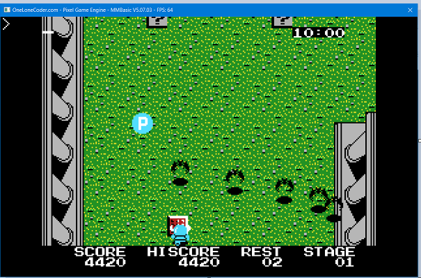

I ran it again and got through to the red wall without any crashes this time but I did not encounter that thing I was just stepping onto when it crashed before.
To download the file I just go to the green CODE button and 'download zip'. I don't know if I want to mess with GITHUB too much. It's my record keeping that is mucking me up but I think I have that sorted.
Bill

Posted: 03:51am 27 Dec 2023
Played a few more times and got to the end. The last time I hit that square thing with the red on it again and it crashed just like before.
Hope that helps.
Bill

Posted: 04:34am 27 Dec 2023
Thank you Bill
This helps a lot. I will take a look at the red box. It is the time freezing box, that freezes enemies for 10 seconds
Edited 2023-12-27 14:34 by LeoNicolas
