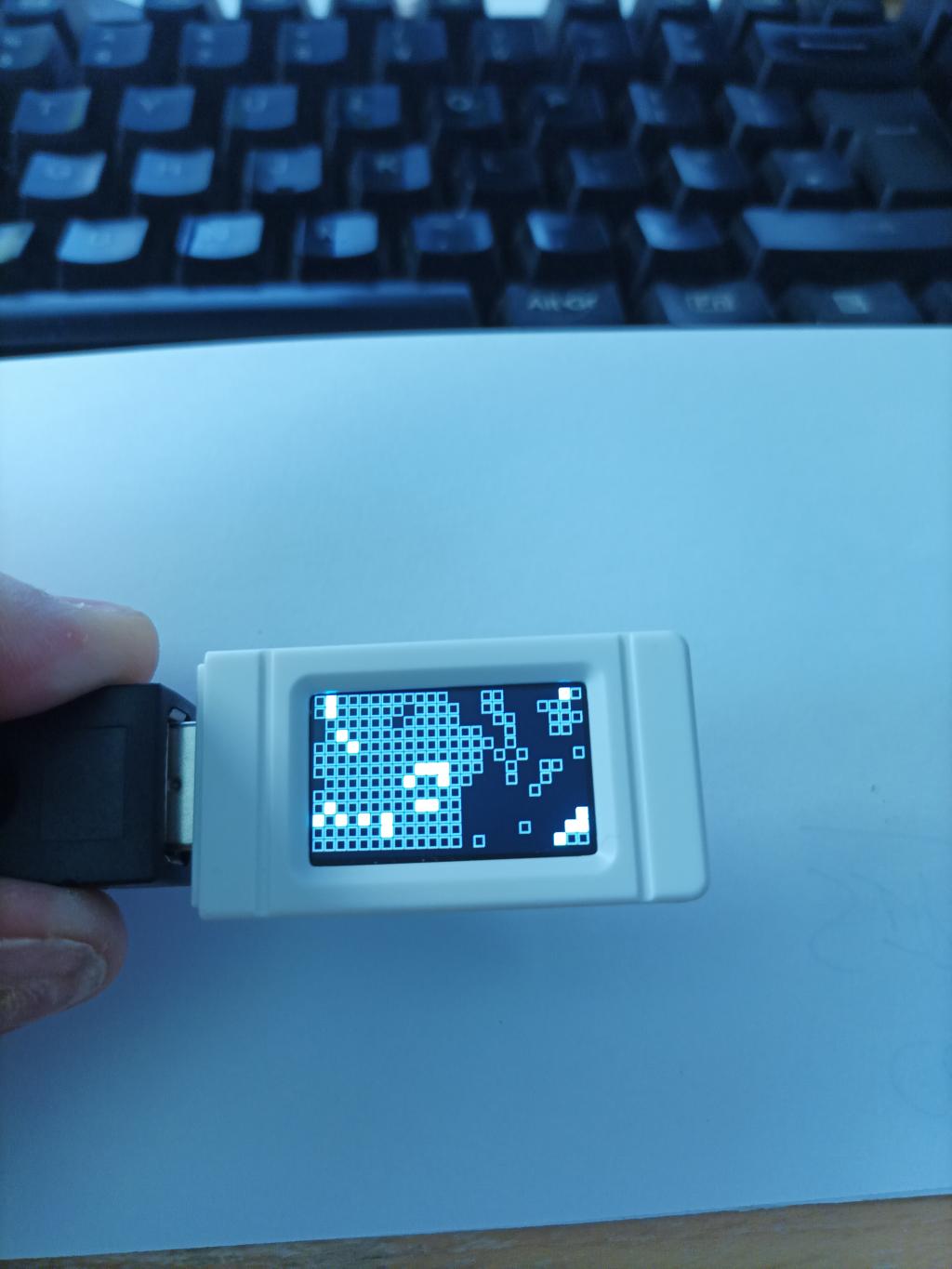

I have been following the RP2040GEEK thread with interest - so I snagged one from The PIHut (£9.80).
Now my needs are "simple" - tinkering, simple sensors, displays and re-acquainting myself with BASIC, so the limited GPIO breakout is not an issue for me.
I must say "wow" for the price and ease of use I am impressed.
Coupled with MMEdit a near as damn it plug in and code solution that "just worked".
Love the additions to "Life" - the "once alive" addition is a nice touch.
Tinkering with this today around the day job (endless Teams meetings) - but bravo all round.

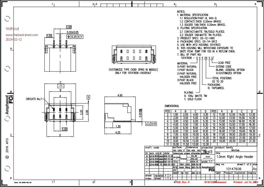

Posted: 10:55am 12 Feb 2024
As for GPIO,
I check dimensions, and currently there are 2x3 and 1x4 connectors with 1mm pitch.
This connector below fits at the footprint of the current connectors, and has 8 more pins (18 total). We need 4 (GP0,GP1 and GP26/GP27) to make it better match MMBasic.
The 4 wires fot these signals will be difficult to wire inside the housing, but I will make a try once I receive the sample connector.
And of coarse, you need the mating part also, preferably with longer wires. That is the next challenge...
P.S. the drawing is a family drawing and does not show the actual 18 pin part.
Edited 2024-02-12 20:57 by Volhout

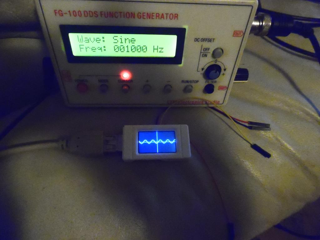

Posted: 09:22pm 12 Feb 2024
I tried SETPIN GP29, AIn that I thought I'd used first but not allowed/error. working scope, gp29 lead
OPTION EXPLICIT
oPTION DEFAULT NONE
option autorun on
 'SetPin GP28,pwm1A 'this optional test signal comment out
 'PWM 1,10000,50  'square wave ,this optional test signal comment out
 dim c%,x%,samples!(480)
 SETPIN GP29, AIn
 adc open 50000,3
 FRAMEBUFFER CREATE F
 FRAMEBUFFER LAYER L
 FRAMEBUFFER WRITE L
 line 0,mm.vres/2,mm.hres,mm.vres/2,,rgb(blue)
 line mm.hres/2,0,mm.hres/2,mm.vres,,rgb(blue) 'draw cross to layer L
 FRAMEBUFFER WRITE F
 do
   adc start samples!() 'get new samples
   'trigger
   c%=0
  do:If samples!(c%) > 0.1 then if samples!(c%+1) < 0.2 then exit do
inc c%:loop while c%<160
math scale samples!(),239/3.3,samples!()'scale to 80 pixel height
FRAMEBUFFER COPY L,F
for x%=0 to 238 'screen width
     line x%,samples!(x%+c%),x%+1,samples!(x%+1+c%),,rgb(green) 'draw new sample from sample(c%)
next x%
FRAMEBUFFER COPY F,N
loop

  Mixtel90 said  Ah....  :)
This version of picomite hardware  ARGGGH!.
The ads are honest , I thought it was something else, my fault.
Volhout wants to redesign it,solder sockets.. "the hidden pins".
see what happens. I've never used a debugger.
