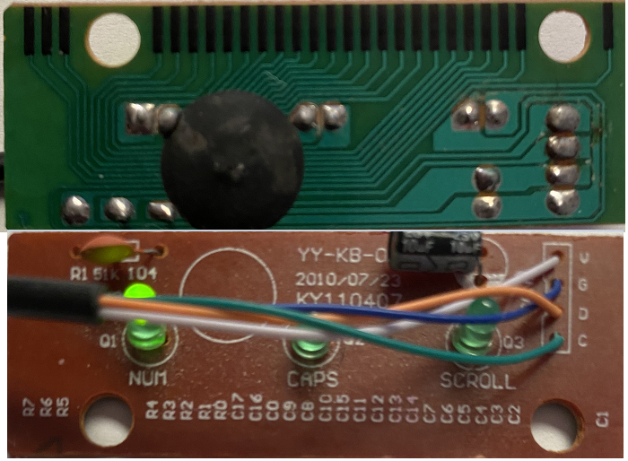

When I found this and found out the price I was looking at was in USD and would take a couple of weeks to get here I decided to pull apart a $2.99 second hand keyboard I found at an op shop and found this:
While it is not quite the same module, I think it's the same under the blob. The columns number from C1 to C17 instead of 0 to 16 on the other one. A short test with a small jumper confirms that C1 on the one I have corresponds to the C0 on the other one (and so on I guess). With the jumper I can type characters into Notepad etc.
I may get a chance to connect a joystick and some buttons on the weekend.

If anyone cares, I gave up on this keyboard blob thing, it's faulty. I probably damaged it with my fumble fingers.
I found the little board difficult to work with and I'm not going to buy more to struggle with. It is quite possible to do and you can easily find youtube videos where some have done so.
So it's back to plan A for me. An Atari style joystick and 'mite with USB connection to the PC to give a single 8 bit word.

  Volhout said  I think your project was the smoothest way into hobby gaming on MMB4W
Thank you Volhout, I believe so too. Many games written for Tom's CMM2 contest were keyboard only and I do have difficulty with the keyboard when games get intense. This could replace the keyboard for those games. I have been trying LeoNicolas' Knightmare game and I can not come near to the dexterity he shows on the video while demonstrating the game. This project would be the ideal way to add joystick control without modifying the code.
Leo is using wine and has trouble with Peter's controller so cannot add it for MMB4W (I believe). While I could add the controller support for my own purposes it is not feasible to do it each tine he produces a new version.

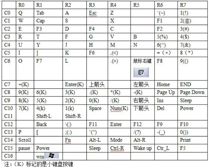

My problems with that keyboard chip PCB are that it is small, the column and row markings are on one side of the board while the 'edge connector' is on the other and my fingers do not work as well as they used to. The data for the board is incomplete.
I want to use the arrow keys for the up/down/right/left of the joystick and the space key for the fire button. The arrow keys are not shown but I suspect that they are R3C7, R5C7, R5,C9 and R5C10.
Maybe I should try again, it's not rocket science. Next time I would use a hub rather than plug it into a USB port of my laptop, that was not a good idea.
