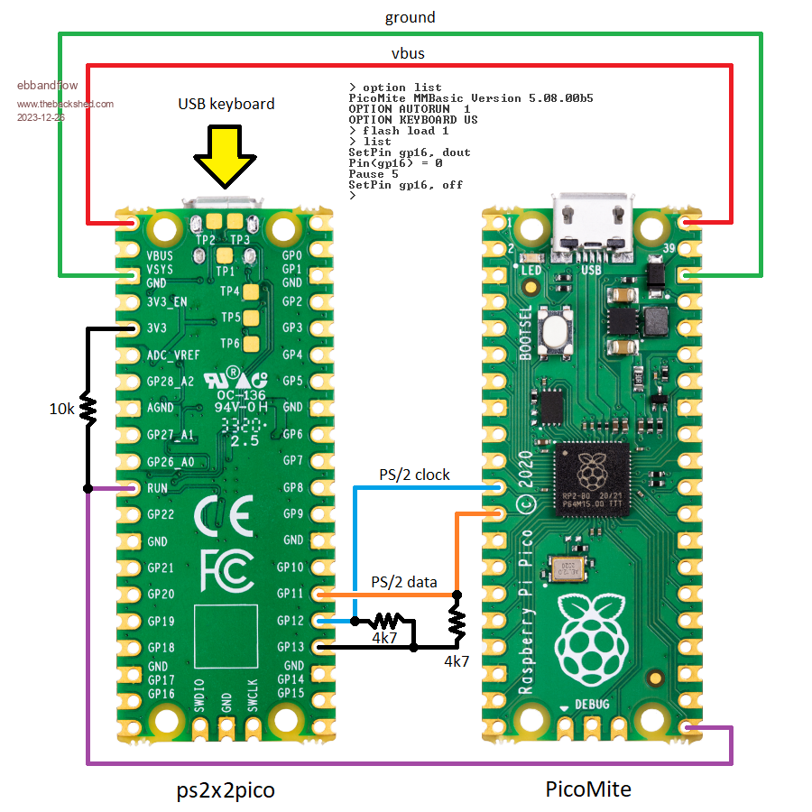

Depending on how you power the pico (e.g. battery + USB), an external schottky or P-FET may be needed. The pico datasheet provides in-depth details in sections 4.4 thru 4.6 https://datasheets.raspberrypi.com/pico/pico-datasheet.pdf
To prevent back-powering the picomite, I think I've decided against desoldering/reversing the built-in schottky and instead just linking vbus (per the last schematic I posted) & adding an external diode inline between the ps2x2pico's micro-usb and the USB type A socket for the keyboard.
Currently looking into power on reset circuits for the psx2pico and thinking about starting simple with a 10uf cap from gnd > run & 10k resistor from run > 3.3v but does anyone have recommendations?

Posted: 05:28pm 25 Dec 2023
Thanks Mick!
I've implemented a similar solution using the run pin, but am searching for a hardware power on reset for the ps2x2pico to avoid tying up a pin on the picomite to do the reset. So far, my tinkering around with adding a cap and pullup to run have not worked :/
This solution is fully working for me:

Posts: 9201
Posted: 06:10pm 25 Dec 2023
Operating the RUN line isn't the same as using 3V3EN. The latter method actually prevents any power to the RP2040 until the other Pico enables it. Using RUN both Picos have to boot and then a reset pulse is forced. Of course, as GPIO pins are floating until SETPIN is used the 3V3EN is definitely low so the SMPS is shut down, much like an off/on switch.

what's gp16 connected to please?
Posts: 9201
Posted: 06:35pm 25 Dec 2023
if the Pico on the right pulses GP16 low if forces the Pico on the left to reset. The 10K pullup is a "boots & braces" resistor as RUN already has an onboard pullup, although it's a bit high.

  stanleyella said  Er,losing the thread. Picomite gets power and sends power to ps2x2pico which powers usb keyboard.. yes?
Explain the extra resistors and reset stuff please. The initial circuit looked good but did it have to get messy?
Sorry to be confusing, I'm just tinkering around to see if I can make this work because I want the same end result as you. The first schematic I posted was an idea that did not work until I added the 4k7 resistors to gp13 of the ps2x2pico as shown in the second schematic. This works, but the keyboard does not reconnect to the picomite after a power cycle until resetting the ps2x2pico by the grounding the run pin. This is shown in the third schematic where I connected gp16 of the picomite to the run pin of the ps2x2pico with a 10k pullup to 3v3 as shown. In the third schematic you'll see the code that autoruns from flash slot 1 in order to toggle gp16 on boot.
Need to think about Mick's 3v3_en suggestion. Ideally I'd like to get away from using the picomite to toggle the reset and have it happen automatically through a circuit but not quite there yet... more tinkering to do.
