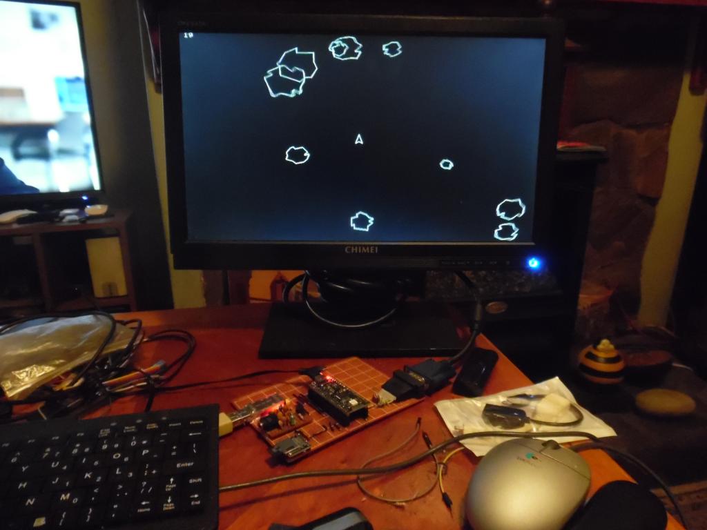

@ Volhout... I got time.. if no one else done asteroids.
working on missile from x1,y1 to x2,y2.. 4 quadrants but using floating point easy :)
it's needed in many games .. missile command, 2d tanks
Posts: 6227
Posted: 08:51pm 23 Jul 2024
Based on Vegipete's teaser.
Do not comment on coding, this is experimental stage. Cleanup of code will be when I know how I am going to implement things.
Fly with cursor keys (UP, LEFT, RIGHT)
Fire with <SPACE>

Posts: 2807
Posted: 07:22pm 24 Jul 2024
looks good
I had to reflash vga usb and mmedit as no mmcc ?
