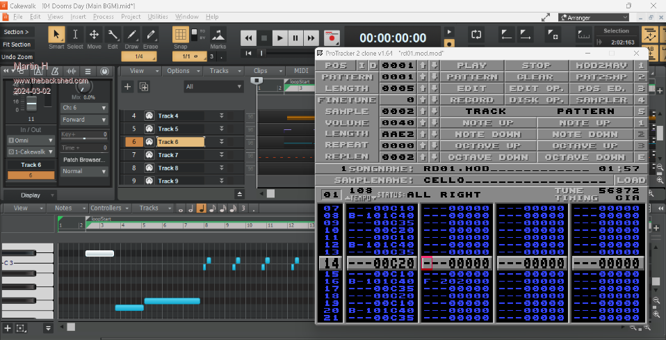

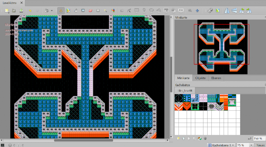

Posted: 03:18pm 01 Mar 2024
After several failed attempts, I have now managed to transfer the tiles to BIN files and display them in the programme.
The framebuffer (F) is no longer in use.
AS02.5.zip
Level 4 is in progress:
Martin
Edited 2024-03-02 01:20 by Martin H.

Martin H.
Joined: 04/06/2022
Posts: 1565
Posted: 07:15am 02 Mar 2024
  Volhout said  While the bin is syill in the libtaty, get csub address (peek....). Get start of flash slot 3 (mm.info....). This is also begin of library.
Difference=offset.
At the address of flash slot 3 it starts with the name of the Library .. the payload start at some Bytes later (the offset).
As the Program is now, this would be a prototype for topview scrolling games and can be used in a variety of ways.
At the same time, I am also trying to save/replay the background music in an MOD file.
Edited 2024-03-02 18:21 by Martin H.
