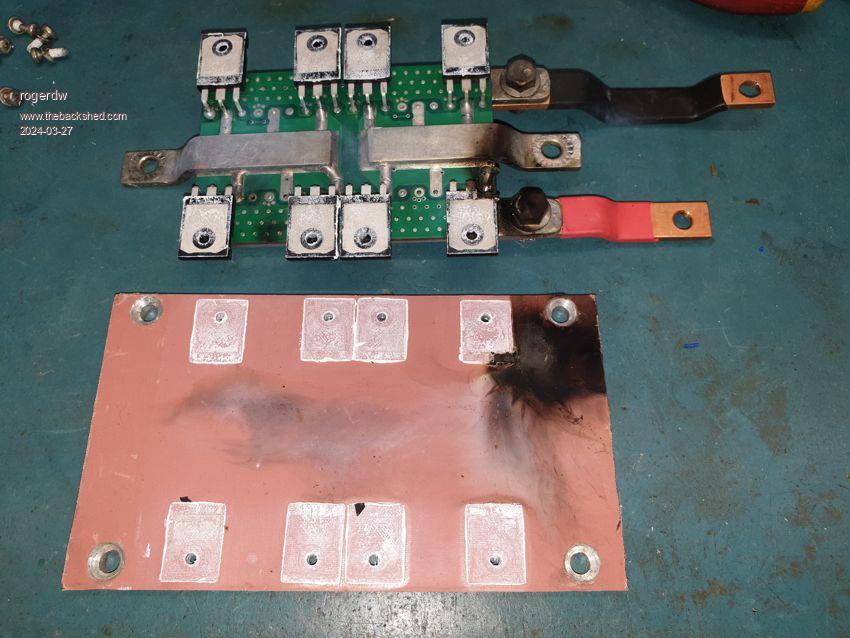

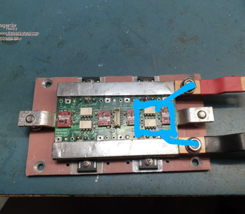

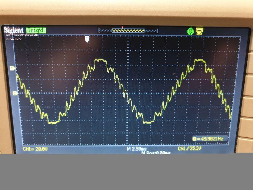

When things go wrong it can be hard to keep track of time and the sequence of events but just before the weekend I came in and the Warpverter sounded a bit noisier than usual  ...  and I just about dismissed it and went off when I noticed the output voltage was 248.5 volts. It's normally never over 241v.
That got my attention so I grabbed my little 24v ac tx and checked the output with the dso. It was very raggedy and was clear one of the smaller inverters had failed. After shutting it down, I could see a couple of blown mosfets on the second smallest bridge  ...  so whipped it out and found the upper and lower mosfets on one side had shorted  ...  four out of the eight.
I replaced them along with the gate resistors and optocouplers and put it back in fairly smartly. A few hours later there was a bang and same bridge was dead again, though all the ones across the top had exploded this time and the lower ones were shorted.
Strangely enough the gate resistors and optos appeared okay, so changed the mosfets and after checking the drive waveforms and connections etc fitted it back in.

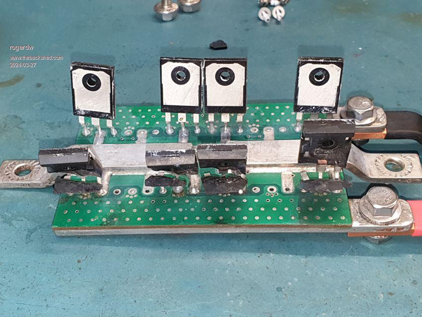

Half an hour later as I was working at my bench in the next room there was a pretty decent whoomph  ...  SSSsssssss  .... whizzzzzzz  ...  tinkle tinkle tinkle. So back in and the rest of the inverter is still running and everything is still on power wise  ...  but obviously the bridge has blown again!!!
I quickly flicked off the AC-Out cct breaker and that automatically makes the ATS change over and put us back on the grid. It is quick enough that nothing crashes, no computers go off or clocks flash  ...  just sometimes there's a single flicker of the lights  ...  and best of all, the wife doen't know that something's failed again.
All mosfets across the top had disintegrated again and bottom ones shorted. I was starting to panic that my second smallest toroid was arcing out inside or something and causing the problem.

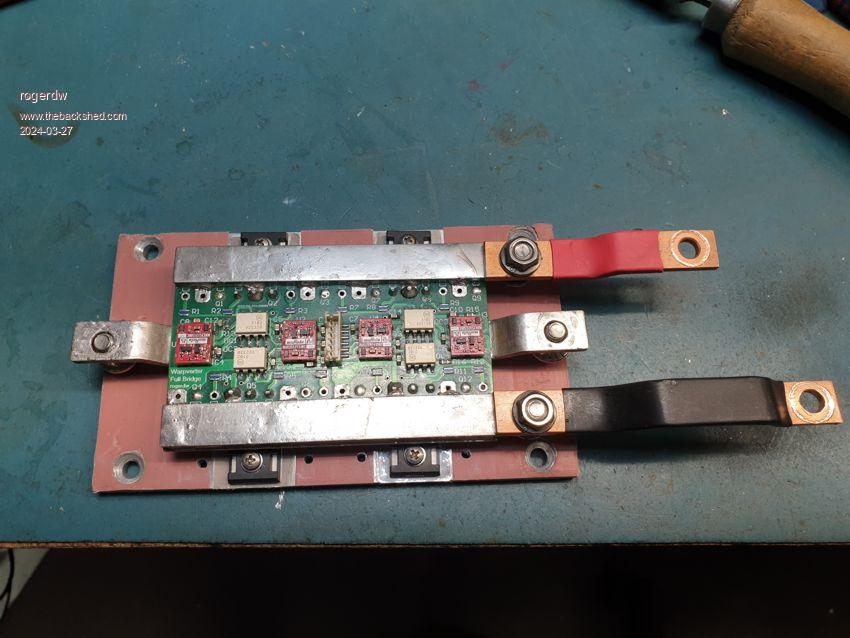

I decided I would fix it and then change around the top two bridges and see what happened next. If the same bridge failed again, it was clearly a bridge problem  ...  and if the good bridge failed in the other location  ...  then maybe the toroid or maybe a drive issue was killing it. And because it was to be used for the very smallest toroid, I just used 4 mosfets and not 8  ...  besides I've nearly run out of HY4008W mosfets
It's fortunate that the blowups haven't really caused any damage to the board and just needs a cleanup to look quite respectable again. The mosfet with the most damage had broken apart and from the molten globules I suspect one leg had flailed around arcing between the tx takeoff and the positive and negative rail  ...  until it went whizzing across the shed and hit the metalwork somewhere.
In cleaning up the thermal pad, I noticed a couple cuts in it and suspect it had arced through. I cleaned it all up and then cut away where the mosfets were going and fitted old style mica washers instead. In communicating with Tony, he suggested some 4.7k gate source resistors, in case there was an issue with losing drive or something  ...  so I fitted them to both bridges. Again it needed new optocouplers, so fitted them as well.
As you can imagine I was pretty apprehensive about firing it up again  ...  but eventually did last night. Then I came inside coz I couldn't face hearing any more explosions. I kept an eye on the wifi power monitor to see that it was still going  ...  and after an hour and a half at bedtime, I turned it back to the mains for the night.
Then back on again this morning  ...  and it's still behaving now.

Hi Roger. That wave form above looks awfully familiar, saw that on my warpverter too .
And, strangely, when it blew it also was the smaller bridge causing me the most headaches. One cause was one of the 16 resistors on the control board going open.
Definitely go for the mica washers, I found the silicon rubber types wanting too.

  Murphy's friend said  Roger, thinking about your small bridge blow up (mine was the tiny bridge causing most grief), I somehow do not think that replacing 200A mosfets with 360A mosfets will fix that.
I'm sure you know about the power sharing of the 4 bridges:
tiny bridge = 1/27th of total load
small bridge = 3/27th of total load
medium bridge = 9/27th of total load
large bridge = 14/27th of total load
So, with your 8KW max load the small bridge takes 8000/27x3 = 889W.
Not quite enough to blow 200A mosfets .
I too suspect its voltage spikes. You might want to monitor the gates of this bridge and see if the switching is clean, no excessive ringing and no shoot through.
I'm no expert with mosfet driving requirements but I did notice that fitting a ferrite bead to the drain leg cleaned up ringing remarkably well (on my EG8010 inverter).
All good points Klaus, thanks. It's funny what panic does to the thinking process  ...  well mine anyway.
I'm reminded of some 6A diodes I used to see that were a common fault on some boards I fix. They often came in shorted  ...  and because I couldn't find any close equivalent quickly, I fitted a 35A 400V bridge and used half of that. Then when I saw more, I just did the same thing because it had worked okay.
Then occasionally one would come back in with the 35A diodes shorted which made no sense when there were still many originals running with 6A diodes. Ater a while I thought I'd try a 1000V bridge  ...  and I've never seen one come back in since. It seems there must be some massive spikes on some of the supplies that was doing the damage. I also add a couple of varistors across the input lines too, so suspect that also helps.
Thanks for the reminder of the relative power levels too. The one that gave me the trouble was the second smallest at 3/27th of the total load  ...  so the fact that the larger two doing the bulk of the work have behaved themselves  ...  and are designed and laid out exactly the same, suggests it was more likely an issue with the actual module rather than a design flaw.
Having said that, an extra snubber type capacitor would certainly add another level of protection to all of them.
I am leaning towards the thermal insulator material having been the problem, so will change them all to mica eventually. The stuff came from element14 and was quite expensive, but they had just folded it instead of rolling it  ...  and it was clearly damaged by the folding process. Had started to disintegrate on the creases. I didn't use any of the damaged bits, but maybe the rest had deteriorated somewhat as well.
Cheers,  Roger
