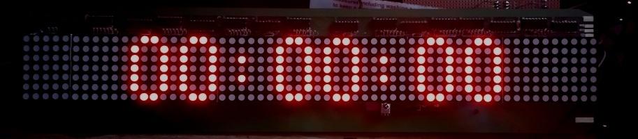

58kk90
Joined: 14/06/2023
Posts: 82
Posted: 12:23pm 18 Mar 2024
What it looks like so far ..
I have hard coded the 0 and the : in the data lines at the bottom of the code.
I'll make up a table of bit patterns after lunch for each digit 0 - 9 and then look at how I throw those into the array as they change with the count incrementing or the time changing etc.
Super impressed by what we've achieved so far
Thank you all so much

I used the internal time$ variable and the bit of code you last posted with a couple of modifications and additions, I now have the hours, mins and seconds counting from 00:00:00 up in 1 second increments, which looks awesome.
There is no flicker at all, so I have taken the time to draw out the schematic of what I currently have and drawn up a PCB for it, the problem is I am doing this on a Pi Pico which doesn't have the WiFi, so I'm at a dead end now as I planned on pulling the time from NTP.
The guy making the PCB is local to me and will do it in 24hrs, so I have also ordered some P-channel SMD mosfets and the other two IC's in SMD packages the entire PCB is in SMD apart from the Pico W and Molex connectors etc.
Hopefully by the weekend it'll all be here and I can build it up and finish it off.
I'll come back and post the final code in case anyone else can make use of it once it's all up and running..
Thank you all so much for helping me get this far, I really never expected it to work as well as it does, just hope I can get the NTP bit running, reading the manual, it looks fairly straightforward.
