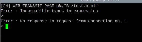

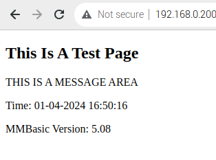

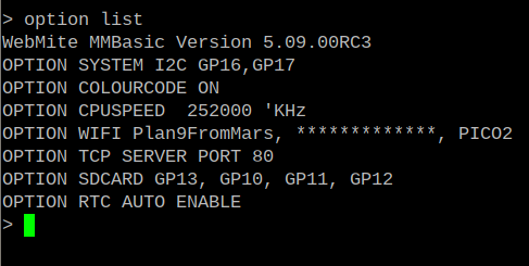

Hans
Joined: 18/10/2022
Posts: 117
Posted: 10:47pm 01 Apr 2024
Hi All;
I posted this problem during the 5.09Beta posts for the WebMite and it was suggested that I re download the firmware again. I have been doing this for every update till now RC3 and still have the same problem.
This worked under 5.08;
These are the current options under 5.09RC3;
The program error message;
The program code;
Dim buff%(4096/8)
Dim string mystring,mytime,currentversion
currentversion = Str$(MM.Info(version))
mystring = "THIS IS A MESSAGE AREA"
WEB TCP INTERRUPT WebInterrupt
   '<do some processing here>'
   mytime = DateTime$(now)
Sub WebInterrupt
 Local a%, p%, t%, s$
 For a% = 1 To MM.Info(MAX CONNECTIONS)
   WEB TCP READ a%, buff%()
   p% = LInStr(buff%(),"GET")
   t% = LInStr(buff%(),"HTTP")
   If (p% <> 0) And (t% > p%) Then
     WEB TRANSMIT PAGE a%,"B:/test.html"
   EndIf
 Next a%
End Sub
It is the same code as in the 5.08 manual with the addition of variables.
The HTML;
<!DOCTYPE html>
<html>
<body>
<h2>This Is A Test Page</h2>
<p>{mystring}</p>
<p>Time: {mytime}</p>
<p>MMBasic Version: {currentversion}</p>
</body>
</html>
I must have looked at this a million times and don't see the problem.
Any ideas?
Hans ...
Posts: 6643
Posted: 06:23am 02 Apr 2024
Hans,
I don't think there is anything wrong with your code.
If you change the / to \ in the filename you don't get the error but no page is sent.
The browser gets a 404 instead of the requested page.
I haven't had a chance to do a full test but there is definitely something astray.
