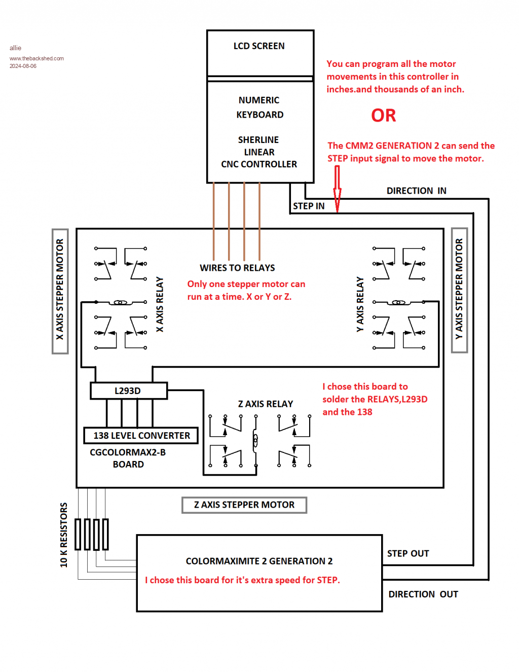

I'm coming from the CGCOLORMAX2 IO pin into an L293D to switch on the selected relays,    only one relay at a time X or Y or Z. Then the CMM2 will give the STEP signal to the PIC16F77-I/P MicroController which is inside of the Sherline CNC Controller.
I'm not trying to run 3 AXIS at the same time only one.
I'll try to send a schematic. It may take me a while to Draw it with windows paint an try to figure out how to post it here. How big of a paint file can I post.

I'm going to try to upload a drawing.
Hope this worked.
Regards Allie

Is there a reason why you aren't using three L293D devices rather than mess with relays? They can be hard wired to the stepper motors and will hold them energised while they aren't being stepped. You just give them a direction and step signal if you get the right modules. Maybe I've not understood the system. :)
Make sure you get good heatsinks on L293D chips. They are horribly inefficient with a silly volt drop. There are better chips around now.

Ah, I see. The 293D is only a relay driver. It doesn't carry the motor current. :)
You close the appropriate relay then drive the motor from the Sherline. I'm a bit slow, sorry. :)
I'm a bit concerned though. Will shorting the windings of a non-powered motor be enough to lock it and prevent it from drifting? I assume that you *will* short the windings. If you don't the motor will almost certainly drift. Steppers are normally energised when stationary.
Not sure what the 138 level converter is doing. It looks like the CGCOLORMAX could equally well be a piece of DIN rail with the relays and a bracket for the 293D.

  The 138 level converter is to convert the CGCOLORMAX2-B's 3.3 volts up to 5 volts that the L293D uses, maybe I don't need it but I had it in my parts supply so I used it.
As far as the motors drifting I had this system working a number of years ago with Parallax's Basic Stamp 2 and all worked good. When not using one of the AXIS X,Y or Z all power will be turned off ** no relays turned on **. The only power going to the stepper motors will be the +24 volts common no grounds.
regards Allie

Hi all, I decided to add a change to this project. I had one Sherline Linear CNC Controller and one CMM2 Gen2 computer and, with relays was going to control the 3 axis of my milling machine.
I just ordered two more CMM2 Gen2's from Rictech Electronics and two more Sherline linear CNC controllers. I'll use one Sherline Controller and 1 CMM2 Gen2 for each axis of the milling machine, X,Y, and Z. I need the CMM2 Gen2 for the step and direction input to the Sherline Controllers. Also I want the CMM2 Gen2's to do a lot more than just step and direction, I'll explain in a later post.
Regards Allie
