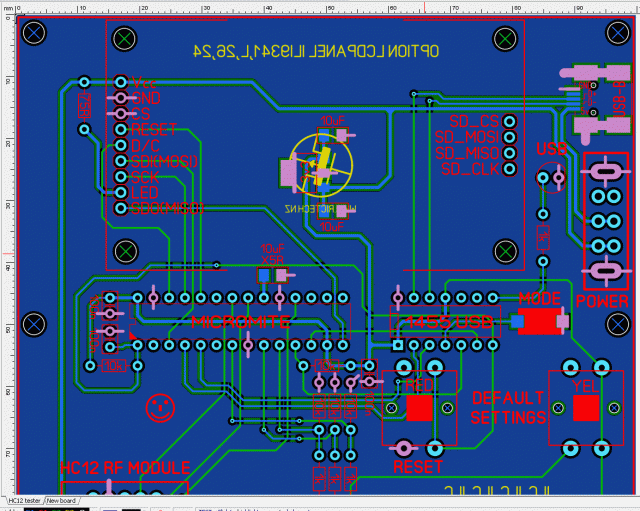

  Grogster said  @ Jim - You asked me to post the images of the old and new PCB.  Did you see anything obviously wrong on my layouts that you would have changed?
The one thing I noticed looking at the images is the GND and CS pins appear to be connected to a copper pour.  Is that section of copper pour truly grounded?
--Curtis
Posts: 2981
Posted: 09:43am 20 Apr 2024
GDay Grogster, All,
Check that the TFT GND pin is actually connected to GND, by adding the switch you ‘may’ have an isolated GND pour meaning that GND on the TFT is at actually system GND.
It is hard to follow the traces with the colour choices but it is basically the same as the original except for the switch and different HC12 layout.

Hi Grogster,
Looking further it does seem that a GND does connect to the Pic and the TFT but that image above is your old version without the new switch.
This is a curious issue.
Suggestions are to minimise it by removing sections you don’t need (like the SD connector and any HC12)
Not much to minimise though.
Are you able to post images of top and bottom copper without the copper pours and individual copper layers (with pours) and without the other layer showing? That would make tracing the wiring easier.

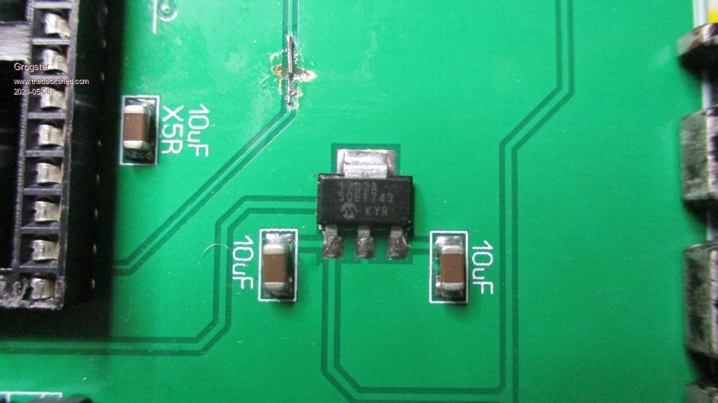

Another thought.
Are the 2 capacitors on the VReg actually 10uF? You may have accidentally used 10nf maybe?
I can’t see any logical reason for one board to work and the other not to.
Turbo46
Joined: 24/12/2017
Posts: 1694
Posted: 04:16am 21 Apr 2024
I did ask about the capacitor and Grogster said it was OK. The PIC does run and drive the LEDs but I guess it could be marginal? Could be worth trying another.
Bill
Posts: 9036
Posted: 09:50pm 21 Apr 2024
The regulator pads look right for the SOT-223 package. I hope that's the one used here as the SOT-89 is different.
Posts: 10009
Posted: 09:53pm 21 Apr 2024
Yes, SOT-223.

Posted: 01:35am 26 Apr 2024
Any resolution ?
Without a deep dive my only thought is that the blue pour connections running between the 170 pins seem thin, maybe one is intermittent or high resistance.

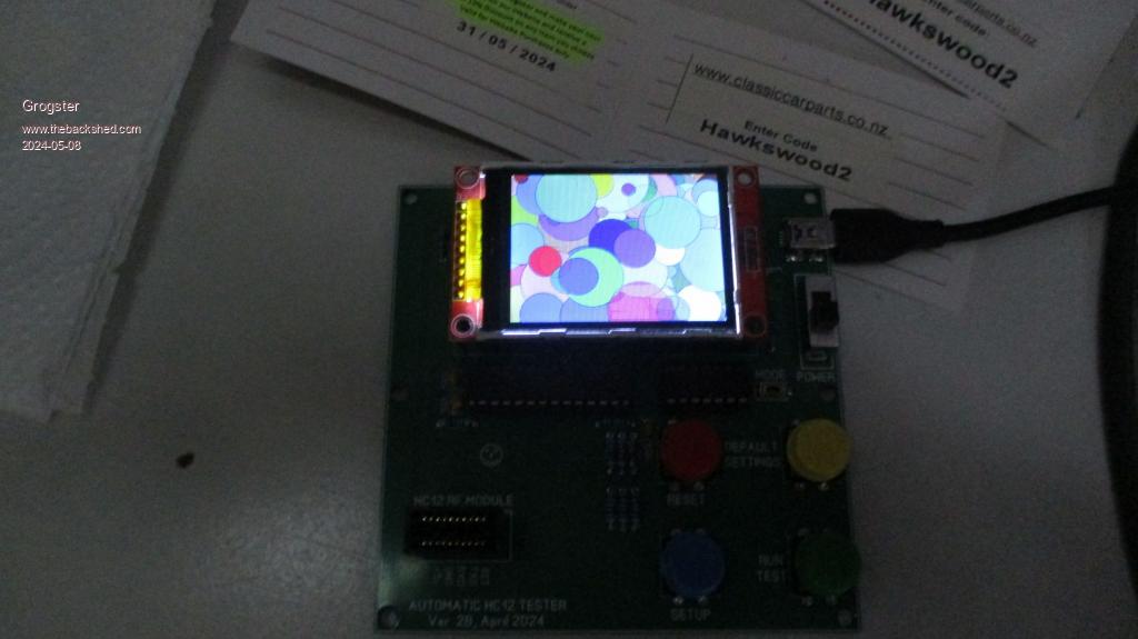

Posts: 10009
Posted: 02:58am 08 May 2024
OK, I have this working perfectly now.
It was a SCHOOLBOY mistake - anyone wanna guess what it was, before I tell you what it was?

Posts: 10009
Posted: 03:27am 08 May 2024
  Glen0 said  Something to do with the power supply?
You win.
I installed the wrong regulator!
Supposed to be MCP1703A-33(3v3), I put in a MCP1703A-50(5v)
As soon as I spotted that, I had a bit of an "A-HA!" moment.
Replaced the 5v regulator with the correct 3v3 regulator, and everything sprung to life - on the original pin-out etc.
I took it from the static sheilded bag containing regs that SHOULD be 3v3, but I must have let one 5v slip into that bag, when I sorted them.  I will now check all regs in both the 3v3 bag, and the 5v bag, so as not to run into that again!
I guess I also should have been checking the part number on the reg itself, rather then just ASSUMING that every one in there, were the correct output voltage...
Again, a pretty schoolboy mistake, and I should have detected that WAY before now, and everyone also knows what assumptions are the mother of...
That mistake, would have meant that the MM2 chip was firing 5v logic(or close enough to 5v) at the LCD, and I guess it upset the SPI port on the LCD module, whose I/O is 3v3 max I seem to recall.
I'm probably pretty lucky that I did not kill the LCD, but it still is working fine!
Probably lucky that I did not kill the 170 MM2 chip too, as it is only rated for 3.6v maximum!
