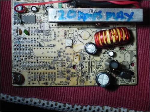

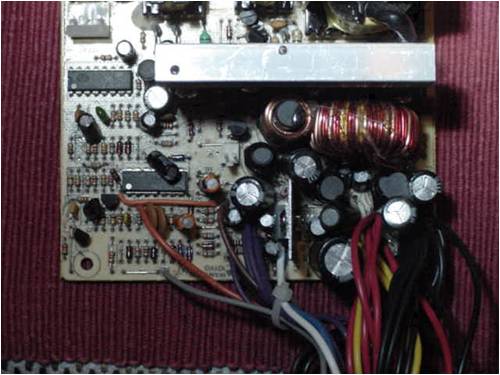

Ok Janne.... I have decided to play with the nearest ATX I could find.... just to give you some positive things to think of.
Here is the complete ATX before being "interviewed"..
And this is what that ATX supply looks like when you remove some one hundred and 5 components that you don't need.
As you can see, it requires very few components around the 494 to make a perfectly stable voltage and current controlled device.
It is better than the AT in that the supply voltage is supplied from the aux flyback supply, and so can go to very low voltage be fully controlled at max current.
This one is now set to 20A max, can be shorted and still push 20A through the meter.
It requires only a handful of bits to work. The oscillator requires 1 resistor and 1 capacitor only. (pin 5+6)
Pin 4 grounded.... unless you want soft start then a cap (10uf?) to pin 13, and a 10k to ground to bleed it slowly... soft start.
Pin 3 .. a cap (222)and resistor (67k **see edit#2 below actually 330r) to pin 2 and the same again as per Dinges circuit... 330r and 10n from pin 3 to pin 15.
A voltage divider to place a ref voltage on pin 2 (from say pin 13 (5v) to ground) to give say 2v on pin 2..and a sample of output voltage on pin1 (with trim pot for control)
Pin 16 to ground and pin 15 to current sense (piece of wire) and trimpot (and 47k to pin 13/14. for bias)
NO other controls are necessary for perfect stability and control.
The outputs stay the same .. ie pull down resistors (1.5k or so) and then off to the totem driver trannies as before.... etc.
From the 494 onwards it stays the original..... all the controlling has been done by now.
The 494's power comes from the flyback aux transformer via small inductor and diodes.... the proper control gets the tossed out, as it is an inhibit circuit. Get rid of it all and approx 30v will go straight to pin 12 on the 494 at switch on. (as it does originally anyway)
So it looks like brutalizing the ATX is every bit as easy as the AT, but requires a lots of unsoldering (I used a heat gun in the finish as so much has to be removed) if you want to bare bones it so you KNOW what is going on..... rather than tracing miles of useless stuff you don't need.
Dinges will be the first to tell you I'm a grubby animal with this stuff.
Lots of good fun.... Dinges this should take you only 40 mins or so.
............oztules
Edit... Janne, I replace the glass fuse with a 270R 3w resistor for the initial test to stop runaway before you establish the right range for V control.... otherwise it may drive the pulse width to max if you dont get the trim pot in a safe range ( so V max doesn't exceed say 28v (change the caps voltage on the output filter for this kind of voltage).
Then check you can control A down to 0 and just over to prove control. The resistor should stay cool at this power level.
When you have the range right, replace fuse... and enjoy.

I agree with Oztules, Janne's PSU looks very unfamiliar; strange layout, very small heatsinks and strangely positioned. Unusual, but of course doesn't mean it can't be (easily) modified. Oztules' PSU, on the other hand, looks exactly like the ones I've butchered.
Did you have any specific reason for disabling the soft-start by grounding pin4/TL494?
[quote=Oztules]Pin 3 .. a cap (222)and resistor (67k) to pin 2 and the same again [/quote]
I suppose this is meant to be 47k.
[quote=Oztules]A voltage divider to place a ref voltage on pin 2 (from say pin 13 (5v) to ground) to give say 2v on pin 2..and a sample of output voltage on pin1 (with trim pot for control)[/quote]
The reference voltage you use is the minimum voltage the PSU will then be able to put out; most PSUs I've seen use 2.5V as reference to the voltage comparator, so output range becomes 2.5-xx V; I've had one that used the 5.0V as reference, straight from the TL494's reference output pin (i.e. without a divider); that PSU couldn't go lower than 5.0V output, so I modified it to a 2.5V reference with some resistors. I've never tried it, but 1.0V as reference may work fine too and would give an even larger voltage output range. May try that myself next time.
[quote=Oztules]Then check you can control A down to 0 and just over to prove control. The resistor should stay cool at this power level.[/quote]
See above remarks; the output voltage won't be able to go below the reference voltage. So all the more reason to aim for an as low (as possible) reference voltage to the comparators.
[quote=Oztules]Lots of good fun.... Dinges this should take you only 40 mins or so[/quote]
Oztules, it takes me that long just to drag my sorry bones into the shop and heat up the soldering iron.
Seeing your bare-bones PCB was quite a shock; reminded me a bit of photos of WW-I battlefields: the vast emptiness... the craters... remnants of what it once used to be... But yes, it's amazing to actually see how few components are needed. I normally leave most things in place, apart from the bits around the output filters and capacitors, because I find my replacement capacitors need all the space they can get. After I've removed the 2 diodes between the LM339 and pin4/TL494, I don't bother with the circuit around the LM339 anymore; it would just be extra work removing all the components... unless you use a heat-gun, of course . But in my experience, using a heatgun on those pertinax (phenol/paper) boards quickly leads to a ruined board and dirty smells in the shop. (though Oztules would probably consider that smell to be like perfume... the smell of succes!)
20A out of one those PSUs is, well, err, 'impressive'. Mostly because the diodes are probably only rated for 6A. Short periods of 20A should be fine, but I strongly suspect a continuous rating of 20A is wishful thinking... let alone 20A at, say, 24V output; the transformer will probably start to sweat at those power levels. Most PSUs I've worked on used the same 3A diodes (2 pcs. of them in parallel), even when the PSU claimed to be able to give 10A. Being mounted on cooling fins and with a fan blowing at them will help a lot, but still. Not my philosophy; if it's rated at 6A, I'd use it at maximum 4A. (Dinges hears Oztules making chicken sounds whilst flapping his arms)
Peter.Edited by Dinges 2009-05-10

Dinges,
Pin 4 .... grounded through laziness.
67k.... It was blue violet orange.....
Your correct about the voltage divider and V min.
Amps min can be zero or so close as to not matter. (my amp meter does not register the lowest A setting)
Interestingly, the duty cycle on the diodes is 50% of whatever the pulse width is. I have used the original ones for 3hour periods (battery charging applications) starting at 15A and finishing at 3A or so. Remember they are 2 diodes in the pack as well.
The ATX seem to use heavier stuff than the AT. These ones can support 10A each forward current(pushing to the limit in the data sheets) with 50A surge ratings @ 200v. (Oztules accounting says... 10 amps all of the time or 20 amps half of the time is close enough.... no wonder no one will employ me )
This ATX one now has d92 diodes (I bought a thousand of them by an ordering mistake years ago) 20A@200v twins. These can run 20A easily.... but still need heat sinking ... very much so... but will stay under 100 degrees @ 20A.
Once the board has been emptied, it leaves lots of room on the heat sink and board for extra diodes in parallel if your keen.
The ATX transformer is quite large on these ones, and so 20A at less then 14v will be sustainable for extended run times I suspect. I have rewound larger E cores and used them for other applications... much bigger.
The aggressive fans on these things allow you to push them surprisingly hard. (not for the feint hearted)
Funnily enough (love the smell of burning components in the morning), if you use the heat gun at the right range, it seems to not denature the board. All the bits rain down on the bench, and she is denuded very very quickly.
Gordon, easily done, and plenty of room to do it. .. perhaps I should have left the 393 on the board.. be handy maybe??
..............oztules

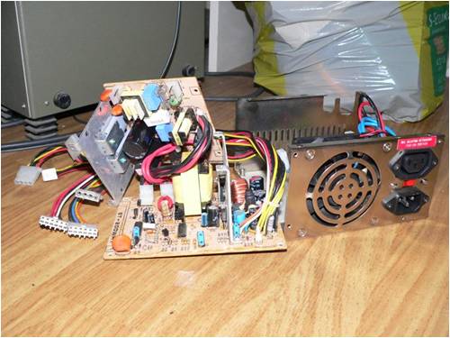

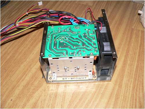

Hi,
Yeah sure, I can pull 105 components out from a psu too in 40 minutes with a heat gun.. though it's 100% sure it will never work after that ..¤%@Q%.. "first atx box i had in hand" adding a little insult to injury eh? now after 7 atx boxes opened one of them looks promising, with KA7500b sitting in the middle.. (also i got another with UC3843, this one actually works, i'll put it into the "mayby" bin.)
Anyways, I went ahead and removed the undervoltage lockout on my "TEMERO" psu.. Now it works down to 6V(with the 20k trimmer at it's maxium), and with current control it will work down to 0V when i short the output. The bad news is that the current control propably monitors the primary winding on the transformer, as when i short the output the current limit magically rises, with the output limited to 2A @ 6V, when shorted it jumps to 8A. This kind of monitoring might work with our battery charger case, but where true current limiting is required it's a no-no. As is, the box seems still useful, so i don't want to "ruin" it by making the wire modification on the output side..
What comes to the battery charger case, the use of the voltage doubling swich will be requided(or a rewind), it takes over 140VAC+ to reach 16V on the output. I can't quite get my head around it, if using all 3 of the phases is possible with the voltage doubling circuit? On quick thinking it looks to me like we're limited to using only 2 of the phases if we will go with doubler switch route. (We're also still researching other options).
In the mean time, I've opened the other AT box for surgery. This one has the "IR3M02" ,sharp equivalent of the tl494. It also has the second error amp disabled, so it seems like a good candinate for the sensing wire current limit-mod. This one is quite odd also:
The cover removed. Everything is boxed between the PCB's and heatsinks.
The workings removed from the case and top PCB opened. The heatsinks (= the 2 aluminum plates) seem rather puny. Edited by Janne 2009-05-10

If you overload a standard supply, you will induce the scr to turn off the 494. In this state, the 494 stays turned off. Only by turning off the ac for a few seconds, will the supply start again... How?
Well, with the 494 turned off by the scr, no power should be available to keep the scr latched, it should give up and automatically restart... but it doesn't. This is because the spurious waveform set up by the positive feedback loop, keeps enough power in the secondary, to keep the scr latched.... so it does work.
Use a scope while it is in this state, and you will see the wave train which is doing this..... this is how it bootstraps.
In normal startup, the 494 sees this voltage being generated in the secondaries, and starts to wake up. It then drives the proper switching pulses into the driver, and swamps the little feedback wave train and we run normally.... until an overload arrives and sends the 494 into stall mode again, requiring a complete power down to recover... thats why we need complete power down, otherwise the bootstrap pulses will keep it alive enough to keep the 494 turned off.
In an ATX, a simple uncontrolled flyback (on the HV side) provides approx 30v onto Vcc of the 494, and it is alive. Other control voltages keep it sleeping until called upon, and it still uses this uncontrolled supply for it's vcc.
In AT's with a resistive bootstrap, it can only be that your looking at a single switch flyback, or dual switch halfbridge... but the pwn chip will be on the HV side of the board, and will require opto isolators to ascertain what the secondaries are doing.....for control.
Janne "In one atx schematic I saw the power to tl494 was provided directly from the HV side by a voltage divider circuit, and the workings of that are clear to me..." This must mean the pwm chip is on the HV side....(likely flyback topology) other wise the LV isolation is compromised. So I would be surprised to see the chip on the LV side for that reason.
Dinges "If I'm not mistaken, the bootstrap method (using a resistive voltage divider, powered by the primary voltage), is used in AT supplies, which do not have a secondary (permanently on) power source as the ATX"...... see above.
As for the heat gun... I use a makita heat gun with no nozzles... broad heat indeed. But if you hold the board with something, and face the draft towards the LV half of the board from a few inches away (but the exhaust heat leaving the board at an angle to keep the good bits out of the hot air, localised burning heat is avoided. In a minute or so, the whole solder regime under "inspection" is melted, and a tiny jewelers screwdriver can easily prise off the bent component lead devices, the rest fall out. These boards have oversize holes I have found. and few components need help.
It must work, as I just did it??.. and the board is still fine.
In the case of the board above I did, all components not used in directly powering the 494 from the aux got the chop. A reference voltage is still available from the 494 at a few ma if required.
Will do more with the full wave in a day or so... have a wool shed to dismantle today... muscles are aching from yesterdays effort
Edit
Dinges, I just looked at the circuit you linked too. It seems the third "positive feedback" winding is still in the driver transformer. It may be possible to use a single diode and capacitor to boot the 494 up without the aux circuit on the atx. (boot pulses should still be there... legacy???..Interesting, although the aux is already in place in the atx and provides stability in the low volts region where the AT may fail.
Another advantage with the ATX, is that you can fire up the 494 and disable the b+ to the switchers, and test your control circuits with a lower b+ and watch the pulse width change as you fiddle the inputs(on a scope). (inject your own voltage into the error comparators and see the results without smoking it up. May be a good learning tool.
.........oztules

Well, it looks like they do use the same transformers. A quick unsolder of the driver transformer, and unwrap of the outer sheath.... shows us the 2 turns are there as suspected. If you disconnect the flyback driver and look for the pulse train.... it's not there..... hmmmmm.
A quick check around the driver bits and pieces and we find that there is no base collector resistor. By slapping two 330k resistors from the base to the collector and we find the pulse train strong and clear.
If you look at the circuit you pointed to, you will see C9 and C10. The 330k resistor goes from neg terminal of the caps to their respective collectors.... and we have an AT startup legacy device.
Useless I guess but we now know a little more. However, if you find a dead ATX supply, that has a faulty flyback circuit, you can bypass the flyback stuff, add the resistors and go on to modify it as normal.
.......oztules
Edit: As an aside, I have noticed that if the flyback driver dies, everything in the whole area dies.... all the diodes, half the resistors, the transistor/s... the whole lot... and all hard to get to. There is a lot to be said for having the driver gear on the LV side of the transformer. I don't like HV logic switching for this reason.... when it goes wrong it goes really wrong.Edited by oztules 2009-05-14
