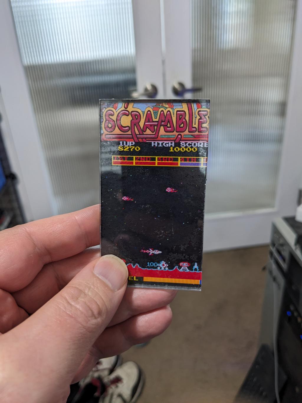

Project #1. Recently I've come to think that part of the fun with retro stuff is being able to handle and touch things rather than just scrolling through menu's of stuff (music/games etc.). To this end I've built a little RFID reader hooked up to an ESP-32 - which in turn pretends to be a USB keyboard. I've hooked this up to my arcade machine and made a bunch of little plastic tags (one for each game). And now when you want to play a game, you have to dig out the tag and insert it into the arcade machine - like a disk or ROM from the old days.
I'm really happy how this has turned out. It really does give a new feel to playing the arcade.
Oh - yeah - I also had to write a custom front end for MAME to interface with the new reader. The only thing left is to 3-D print a case for the reader.
