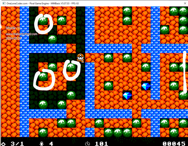

I guess the 3 rocks are supposed to roll down like in the original BD?

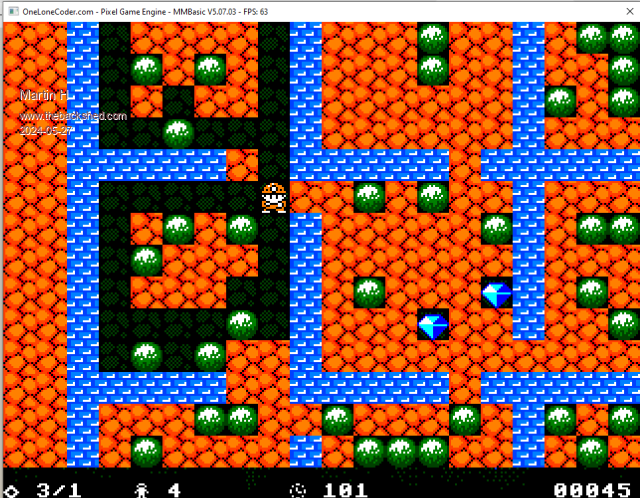

as long as they lie on dirt, they dont fall.Conversely, it means that a rock falls diagonally if there is another rock or gem underneath it and the diagonal path is clear.
This is no different to Boulderdash versions i played.
It also doesn't claim to be a Boulderdash clone (different tiles, levels, sprites and music) but a game based on the principle of Boulderdash.
So if something works differently than in Boulderdash, then that's how it is
Martin
