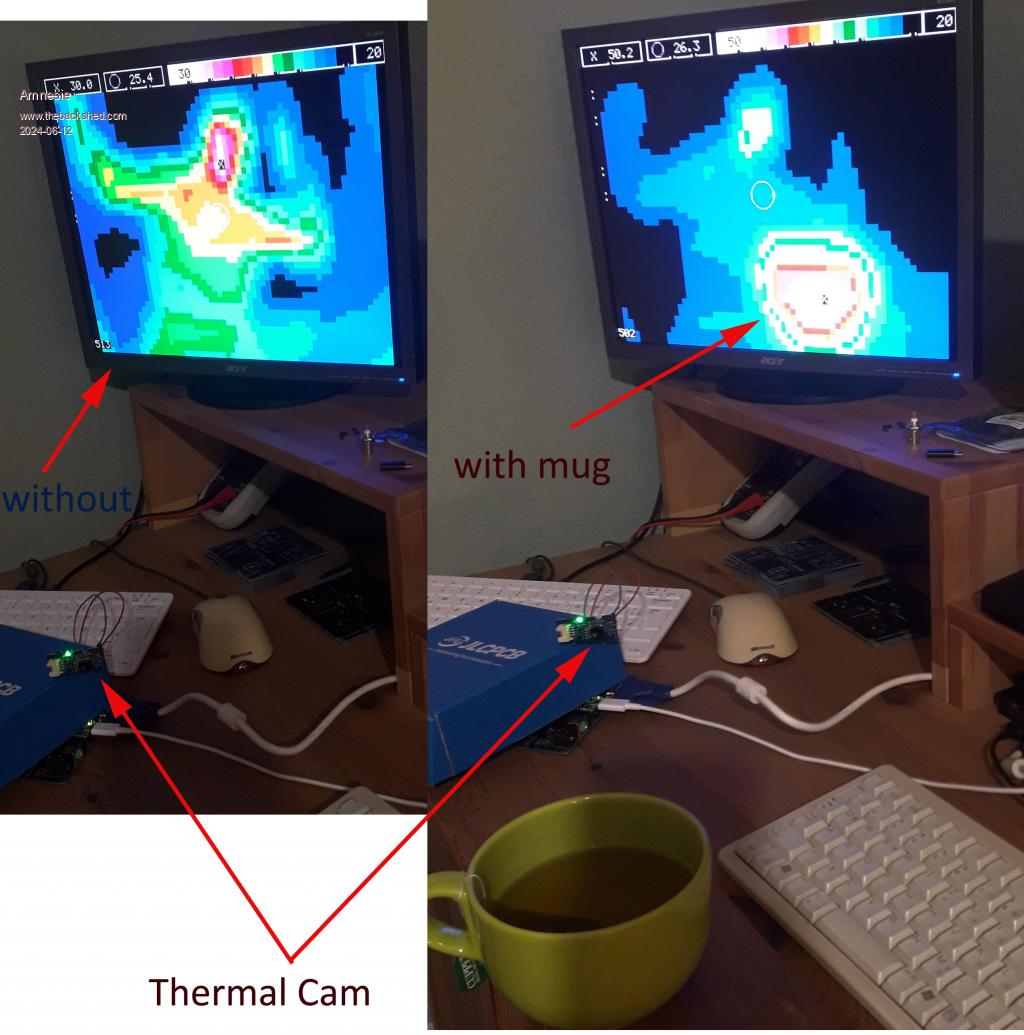

Posted: 09:14pm 11 Jun 2024
Hi all,
program works great, no problems so far! See some comparision with a hot mug of tea and without just waving into the thermal camera.
Images from the latest software "MLX90641_dev_20".
I think there are MANY applications for this, monitoring events etc.
P.S.: I have the 110 degree view version of the camera module.
Greetings
Daniel

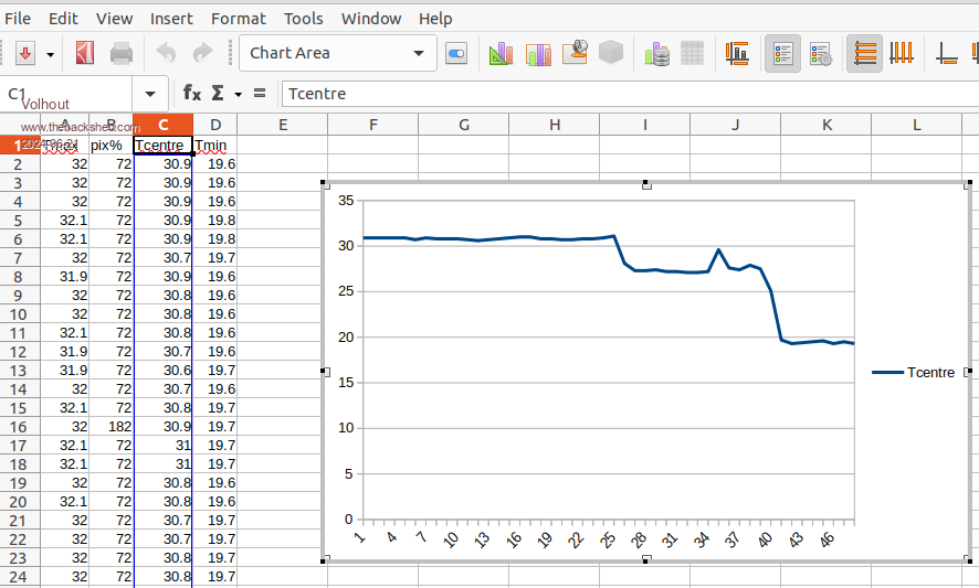

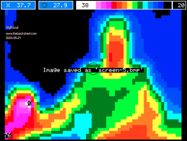

This is the first beta for Game*Mite.
The MLX90641 camera connects to the Game*Mite expansion connector X1, similar as a 1970's photo flash on top of a camera. I2C on GP26/GP27.
The program auto configures for the Game*Mite.
User interface:
- START exits the program (same as Windows....hihi) and return to Game*Mite menu.
- B starts and stops logging
- A save a screenshot
The data is stored preferably on SD card in B:/TCdata, but in absence on A:/TCdata
The program has a configuration for "selfie mode" (camera facing operator) or "camera mode".
MLX90641_gm_23.zip
Log data from the CSV file in Libre Office Calc (similar MS Excel)
Screenshot from the camera in selfie mode (with a hot tea).
You need the PicoMite software from this thread (not the main RC5 at time of writing)
V5.09.00RC5_with_color_map_fix3

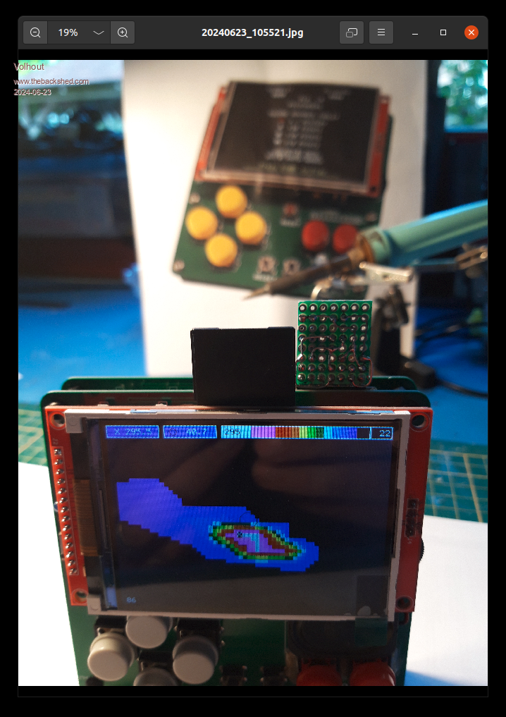

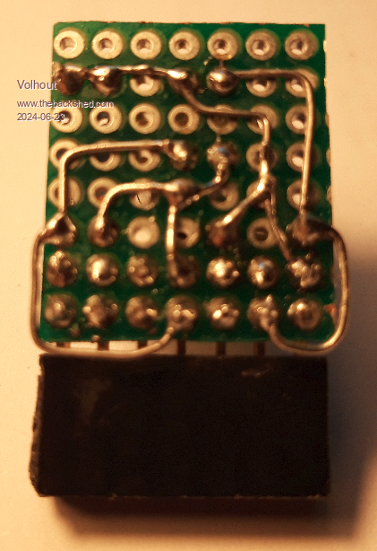

Posts: 6171
Posted: 09:12am 23 Jun 2024
Hi Tom,

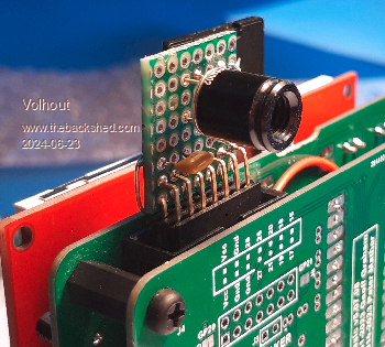

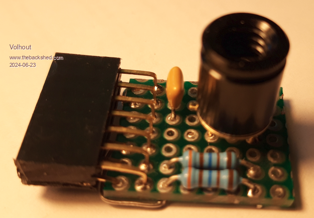

Some pictures of the camera and Game*Mite.
Camera on a piece of experiment PCB
Wiring of the PCB
Camera plugged into the expansion socket of the Game*Mite
Camera in action, measuring the temperature of a soldering iron. Around 310 degrees (leaded solder, for unleaded solder you need 360 degrees).
If you want the camera module to show it at your local computer club, I can send it to you. Or build you a copy.
P.S. I see in the action shot, that there are vertical lines in the LCD. These where NOT in the picture I uploaded. It must be some artefact of the scaler on the forum.
P.P.S. I see by the shape of the soldering iron that the camera is in selfie mode. Changed it in the code, but forgot to save the camera mode.
Edited 2024-06-23 19:21 by Volhout

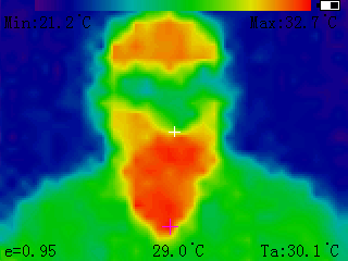

Posts: 2807
Posted: 03:44pm 24 Jun 2024
Volhout- very nice job.It must have been a task getting the camera to work with mmbasic. data sheets are no fun. well done. Thank you for sharing.
The price of the built camera I bought with lcd and battery was only £25. ok, weeks to arrive but same price as just the sensor, depending where you look so cheaper to unsolder the camera sensor than just buy it!?!...and the ready built is 32x24, usb rechargeable,32 bit cpu, saved bmp to win. the prices don't make sense.
as said, they are useful . interesting perhaps but even 32x24 at 8 fps does not show enough detail to replace a £5 handheld contactless thermometer with laser pointer for most things you want to test. imho.
too old to believe the advert hype, stan
edit... getting the camera/sensor and working with mmbasic from this thread would have been more entertainment.
