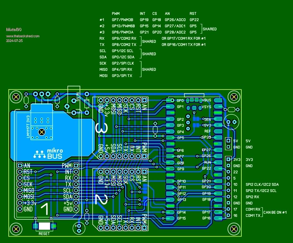

Definitely not intended to do it. :) It's a totally different concept.
I've no Click modules and have no experience of them, but I know that they are designed as IO modules. As designed RPZ compute modules are too small to accept even a small Click module. They are also "intelligent" in their own right and are capable of operating independently, only getting occasional commands from the master controller.
I designed a board for Click some time ago but I've no idea if it works. I couldn't test it. :) I'd suggest that if you want Mikrobus then the best way is to use a Mikrobus system, not attempt to shoehorn it into something else.

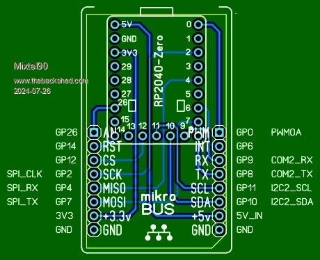

I was thinking more of the zero / rpz boards morphed onto a click module. So they could then plug into a mikrobus bus and use it and the range of accessories. [ assuming the range is still available ! haven't seen much of them.]. Just an idea.

Something like this?
The problem is that each Click module is a slave. They are selected by the CS pin, I think. Putting a Zero onto a Click module gives you something that could probably control one other Click module, but maybe not two as to comply with the Click spec it only has one CS pin.
However, if you chose the modules correctly one could be on SPI (as a slave) and the other on the COM port with the COM one continuously active.
It probably limits what you can do with it.
Further comment added:
I suppose, if pullup resistors were added, this could be used to control Click modules that hang only on the I2C bus, if such things exist. This stuff is pretty much outside my field, as I said.

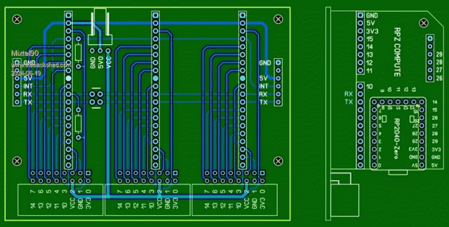

Looking at the standard RPZ -
I think they could be paralleled in bulk ? Say with the right-angle connector as in the module, with the power and I2C pins in common connections, maybe 16 or so ... I am going to get a zero now
PS what is the size in mm ?
Edited 2024-07-27 10:24 by zeitfest
Posts: 9204
Posted: 06:34am 27 Jul 2024
Paralleled in bulk? Do you mean like the motherboard on the first page of this thread? They were always designed to do this. They will pack closer if you rearrange the IO tracks & connectors, but remember that some have a module plugged onto the front and some have it plugged onto the back.
You *could* similarly parallel the bare RP2040-Zero, but it would be difficult, using three PCBs if you ever wanted to make the stack repairable. :)

Posts: 3885
Posted: 01:44pm 08 Aug 2024
  Mixtel90 said  Here's my idea for a simple multi-processor controller using the RPZ compute module.
Did you ever publish gerbers for this?
Actually, I'm only interested in the 3x part--I already have the RPZ board in quantity.
