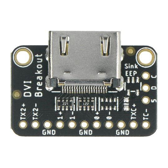

to be ready when my Pico 2 is available, I have just ordered some Adafruit 4984 DVI Breakout Board - Adapters with HDMI/DVI-connection.
  Quote  should be connected to the pins of the Pico board as follows:
GP12 to D0+
GP13 to D0-
GP14 to CK+
GP15 to CK-
GP16 to D2
GP17 to D2
GP18 to D1+
GP19 to D1-
https://botland.de/raspberry-pi-pico-hat-pin-expander/19784-dvi-breakout-board-adapter-mit-hdmi-dvi-anschluss-fur-raspberry-pi-pico-adafruit-4984-5904422347543.html
The price of €2.90 is hardly more expensive than I have to pay for VGA sockets and i don't have to worry about complicated soldering
Edited 2024-08-18 20:02 by Martin H.

based on the attached datasheet of a similar connector (available from element14), it looks like the pin spacing is likely to be 1.50mm between each pin in a row, and 1.50mm between rows; of the 3 rows, the middle one offset by 0.75mm.
4161918.pdf
this should be relatively easy to solder, although that Adafruit 4984 DVI Breakout Board posted by Martin looks good, especially since it also includes all the 220 ohm resistors. how obtainable are they at a reasonable shipping cost?

That's the one I've ordered, for same reasons as you Martin :-) I think it's that one, or very similar, that Peter is also using for his development setup.

Posts: 9205
Posted: 11:03am 18 Aug 2024
That was the board that I looked at and was showing no stock.
Pimorini - out of stock
Pi Hut have 3 but their postage is 2.90 for a 1.90 unit
Cool Component - sold out
Proto-Pic - Add to wish list
Postage prices from RS, Farnell, Mouser, Digikey etc. are stupid here unless you can make up minimum order charges. That's why I don't bother with the big suppliers unless I have no choice.
Those were the connections that I'm designing around - the same as the "shoe" board for the Pico DVI output.
