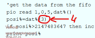

Posts: 6231
Posted: 04:56pm 09 Jul 2026
Top of the code contains a line that enables assembly, and a line that says use test signal. Set that line from 1 to 0.
Edited 2026-07-10 02:58 by Volhout

Posts: 6231
Posted: 06:32am 10 Jul 2026
Hi Phenix,
I am glad you have it working. In hindsight, looking at the code, it could have been better. You can clearly see that it is a derivative from the quadrature decoder, acked together rather fast. I feel a bit ashame I did not make it better.
But now we know it works...
Thank you for debugging.
