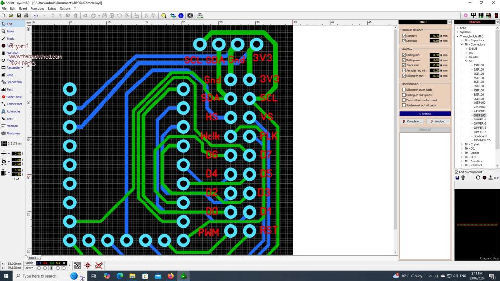

Bryan1
Joined: 22/02/2006
Posts: 2217
Posted: 05:49am 23 Sep 2024
Ok just had to come down from the shed and get this PCB designed
The board measures 35x34mm and all tracks fitted easily on both sides, now as I2C will be new to me do I have it right where the SDA and SCL lines from the camera module are tied to the zero and the output I2C pins ?
On the zero D0-D7 are the bit lines, GP9 is XLKpin, GP10 is PLKpin, GP11 is HSpin, GP12 is VSpin and GP13 is the resetpin. Now as GP8 was free it was connected to the WCLK pin on the camera so the camera registers can be tweaked.

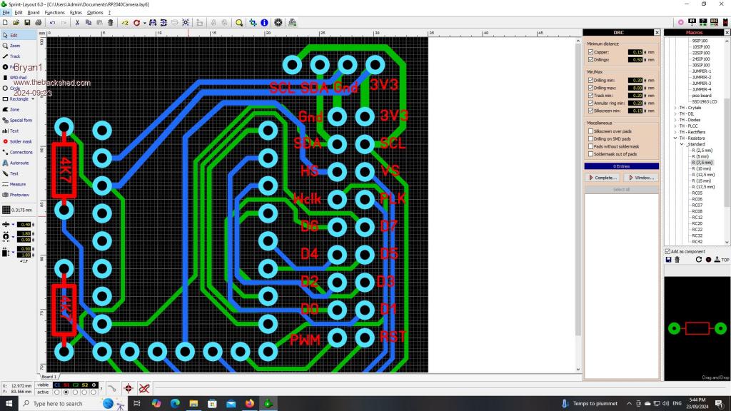

Posts: 9038
Posted: 07:44am 23 Sep 2024
When using I2C you have to provide pull-up resistors on both lines to 3V3. I would suggest using 4K7 for these. You only need them at one end. It's helpful if all devices are powered from the same 3V3 supply, however *officially* this isn't necessary.
On the Pico we use 3V3 I2C wherever possible. The signal levels will often work with 5V I2C devices providing the pull up resistors are to 3V3 and not 5V.
GP8 and GP9 are the pins usually used for attaching a PS2 keyboard to the Pico or a USB-TTL converter to connect a USB Pico to the console (as the USB connector can't be used for that when it's in Host mode). If you want to use them for anything else you will have to use OPTION KEYBOARD DISABLE and only use the console for configuration access. It's good practice (IMHO) to always reserve GP8 and GP9 if possible. You can use different pins if using a console, but you do need them on a hardware COM port.
Bryan1
Joined: 22/02/2006
Posts: 2217
Posted: 08:23am 23 Sep 2024
Duly noted on the pullup's now I was going to put the pullup's on the sea of holes but found room beside the zero. For future I will keep that in mind about GP8 and GP9 but for this first LCD project no keyboard will be needed and with the next one I can put in a PS2 port now I know what those pins are for.
If you guy's reckon everything is right I'll get this board off to JLCPCB and I reckon with the credit I have there will pay for these boards.

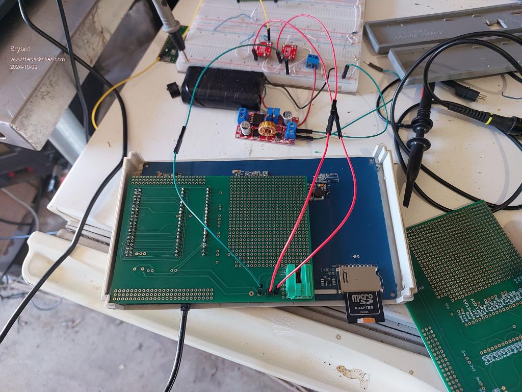

Posted: 05:05am 09 Oct 2024
G'Day Guy's,
           Well those SSD1963 boards were there when I got home from holidays so made one up and first mistake as the 20x2 LCD connector is under the board the pico and the soldermask should have all gone on the C2 side
Now what I found was when the pico was connected to the board the led on the pico stopped and lost the console. Found by cutting the track between gnd and 3v3enable fixed that problem.
Soldered on the power and ground pins this morning and no life from the LCD at all so there is some mistake there that I'm not seeing
Got correct power going to each rail and nothing looks to be shorted.
Regards Bryan

Posted: 07:09am 19 Oct 2024
Well I reckon I have confirmed the 7" lcd is gone as I did setup a pico on the sea of holes where I got to the SDcard working but nothing on the screen, now what was interesting when I did try a GUI Calibrate got a message saying the SDCard was disabled. I have checked all the connections and they are right but no life from the LCD so I do think when I connected that first board I made killed it.
Which does now bring on that second board I made where a Zero sits on the back of a OV7670 camera. Both the camera and Zero will need sockets fitted first to raise the Zero and second to give more room for mounting the camera.
So finally I got onto some pico W's as the place I'm going to put these camera's is to capture local wildlife like that pic I just put in my thread in the section no-one reads
Ordering on Ali is a pita as what I bought first thinking it was a picoW was just more 2040 pico's so back on with a different seller and got 5 of them coming as I do have 5 camera's.
